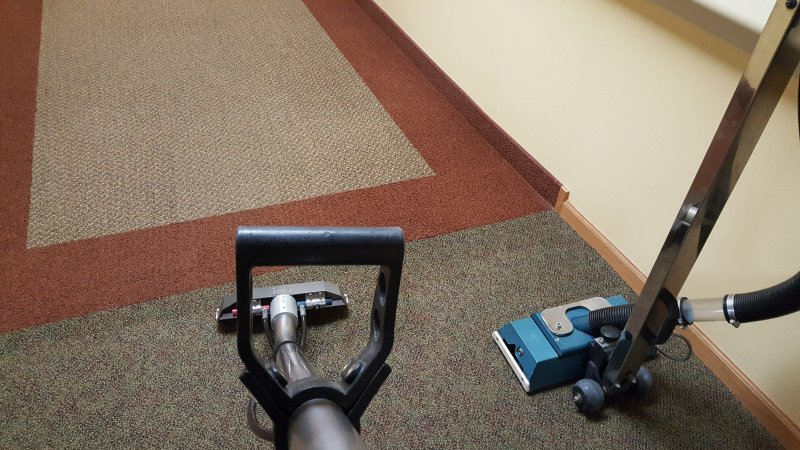

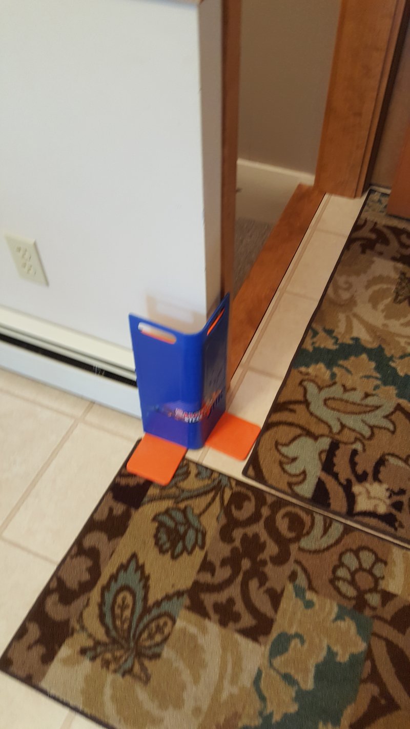

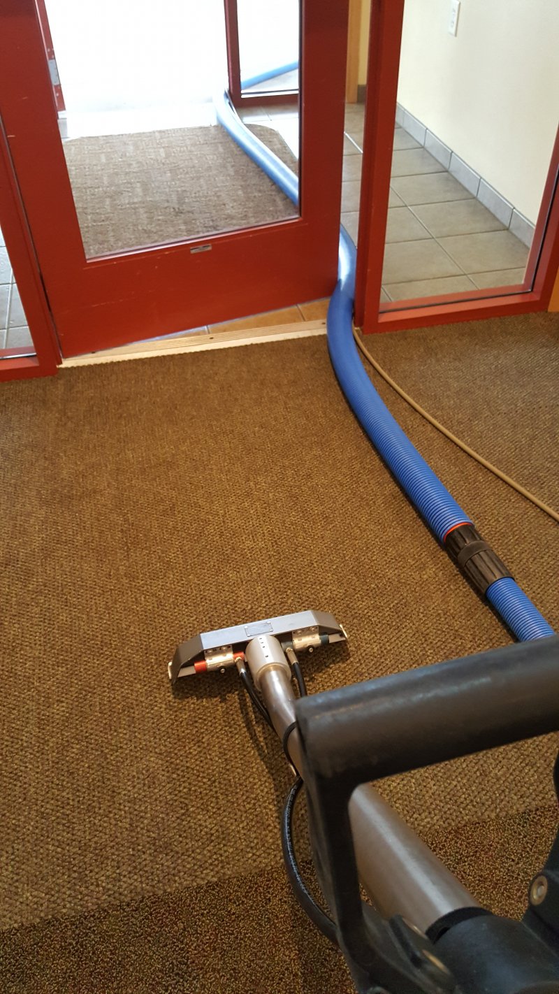

Today, we were pretty busy... Bit overbooked but it all worked out.
Was thinking today because everyone was in aw of our equipment and set up...
Even I was thinking about "why did I use this tool vs one of the others (which I also get asked by other cleaners)
Today vans were split up most of the day, so I asked my guys during our last job together what they used...

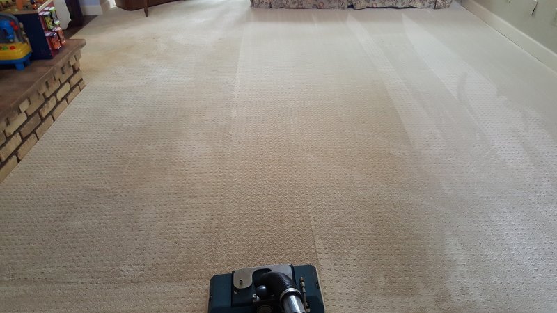

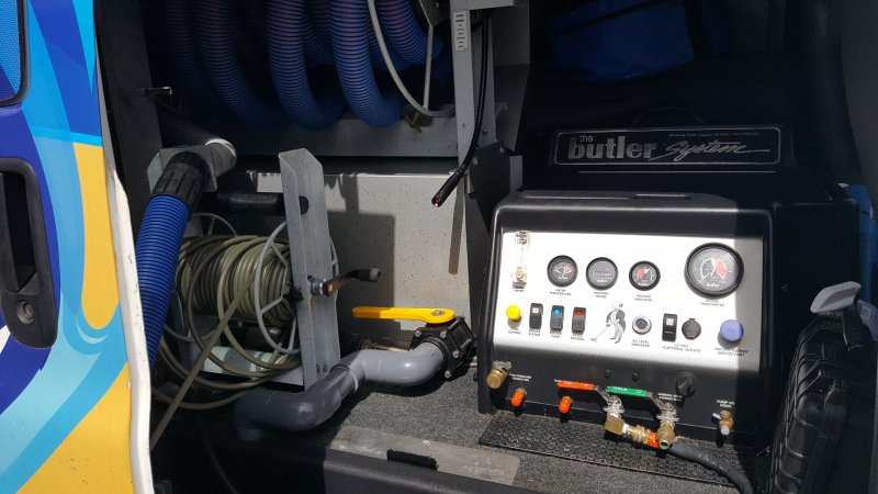

TRUCKMOUNTS USED : Butler High Heat 2 units
Me:
Job 1:

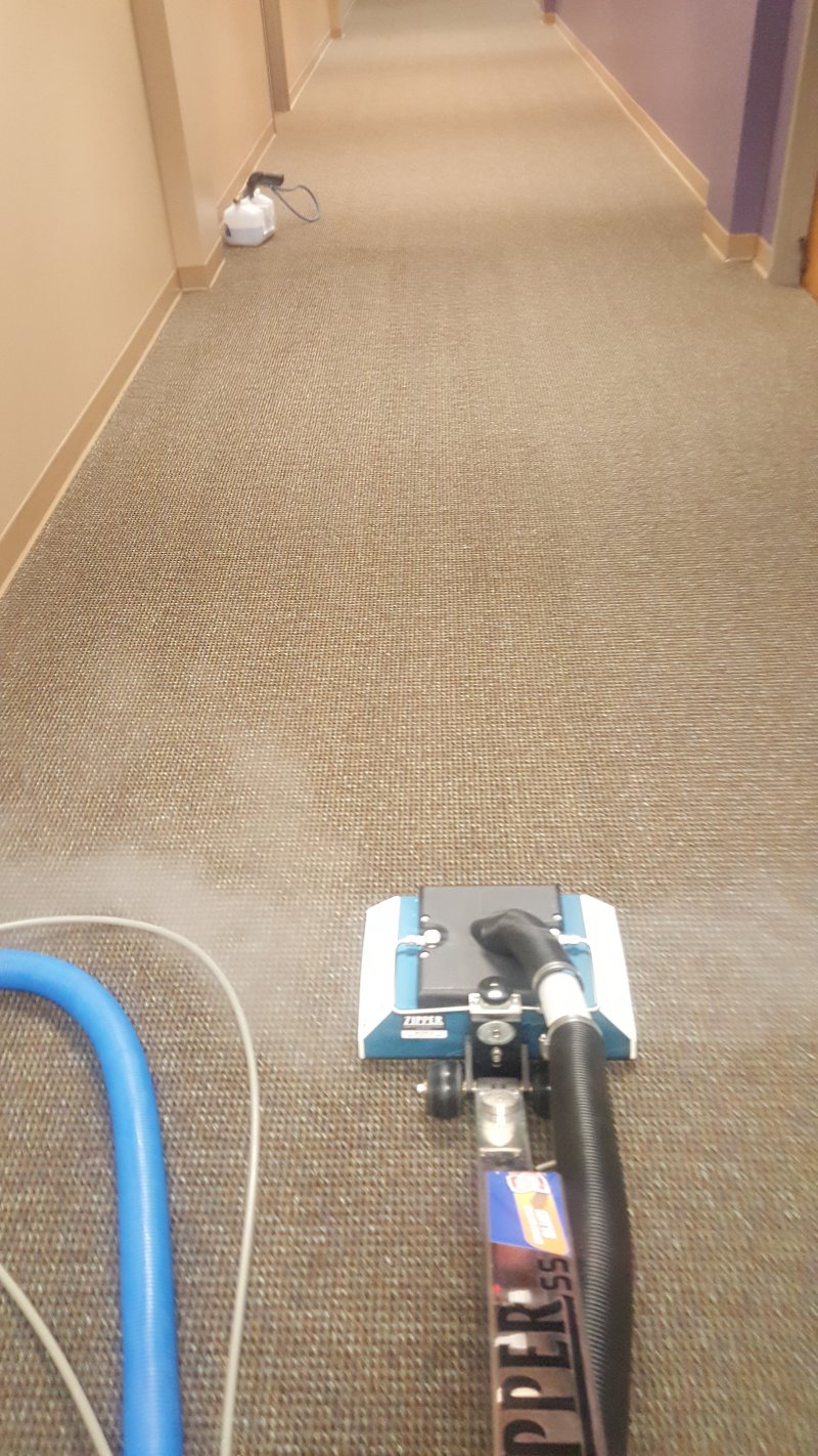

They prevacuumed both 1 and 2
Church 15 inch Zipper with 12 flow
Multi Sprayer brand inline high pressure sprayer
Seal-A-Door Super Screen
Duk Guards
Tom Conway new Devastator swivel head wand for humpy areas (and let the pastor of the church try Zipper and Devastator as he was a former carpet cleaner and Janitorial)
small mini fan

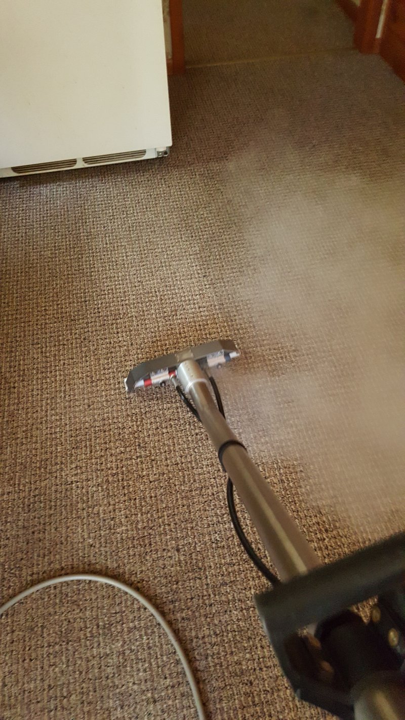

Job 2: Church residents next door
Same as above but used Zipper SS Super Spinner instead and now Devastator wand.
Urine situations so used Cobb Light and a Hydro sensor....

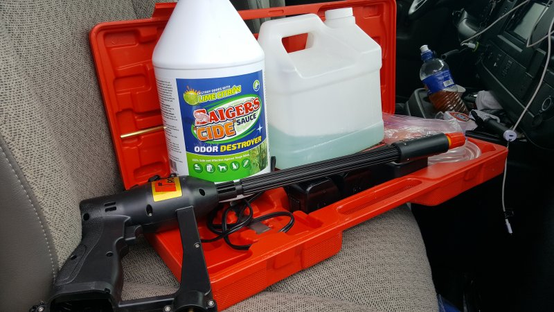

IPS Pro Sprayer to Apply Saiger's Cide Sauce Lime Citron Odor Destroyer after
Also Grand Groomer to groom carpets and disperse Lime Citron Odor Destroyer
Duk Guards
small mini fan

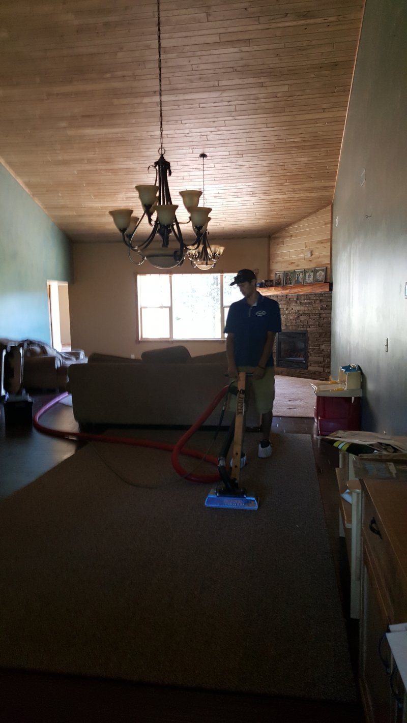

Job 3 after 30 mile drive
Residential
Prevac

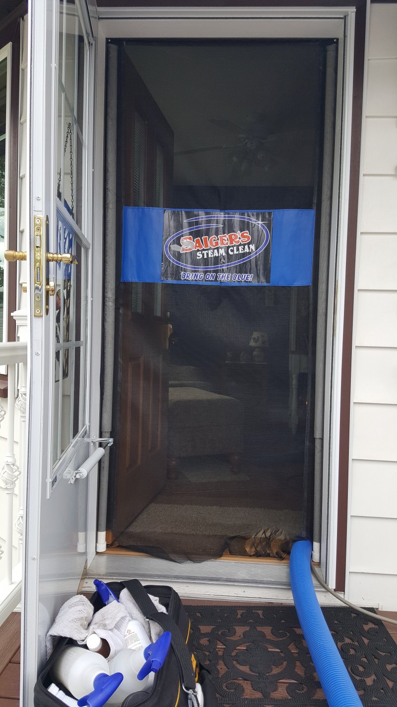

Multi Sprayer brand inline sprayer
15 inch Zipper
Saigerized PMF swivel head stair tool
Grand Groomer
Job 4
Residential
Prevac
Duk Guards
Neoprene Floor Coverings
Grand Groomer
Job 5

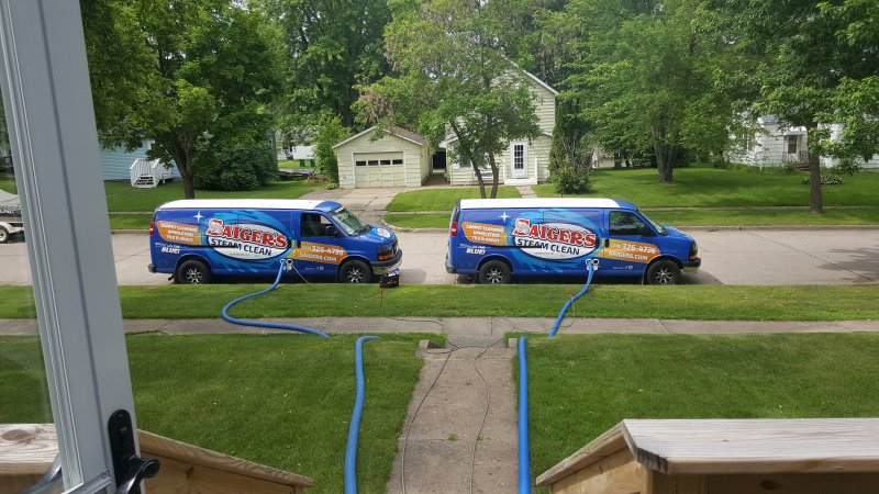

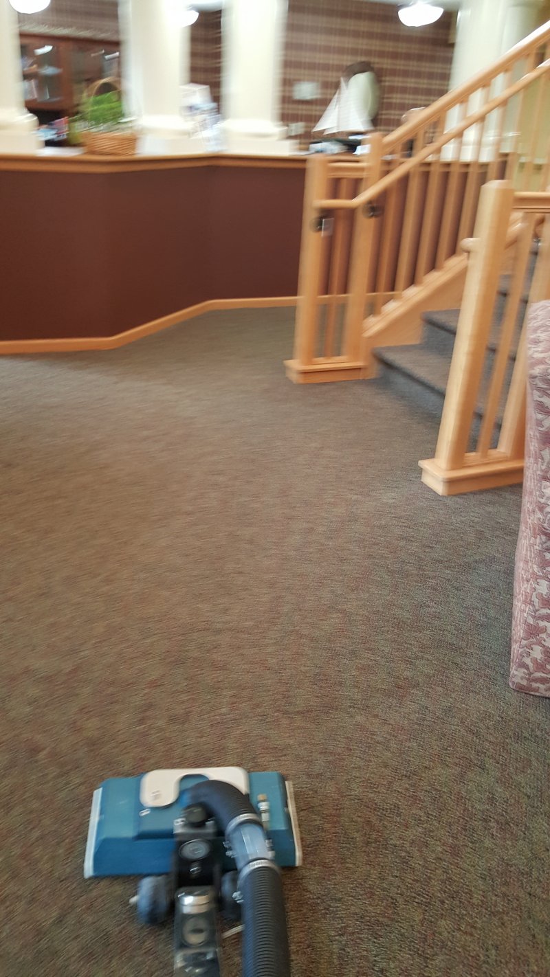

Both vans onsite elder care facility (Jimmy not found though :) )
15 inch Zipper
Tom Devastator Wand
The Boys...
Job 1:
Residential
Prevac all

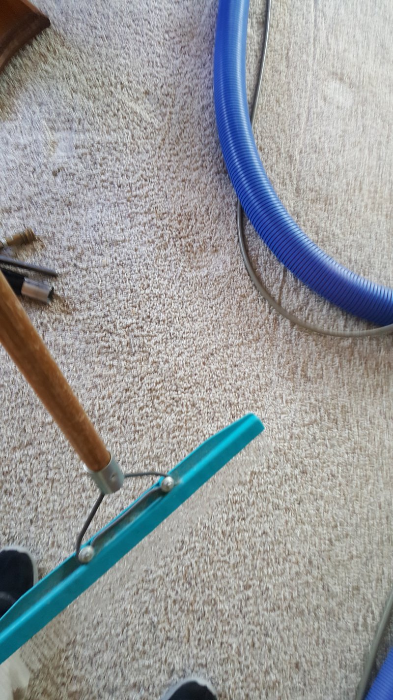

10 inch CRB
Regular Seal-A-Door
Sapphire Scientific Upholstery tool
Duk Guards
small mini fan
Job 2:
Residential *Spot removal*
Tom Devastator wand
Duk Guards
Job 3
Prevac
10 inch CRB
15 inch Zipper
Duk Guards
Grand Groomer
small mini fan
Job 4
More Puppy Whiz....
Cobb Light and Hydrosensor
Prevac (safe areas)
10 inch CRB
Duk Guards
Grandi Groomer and Grandi Brush style Groomer
small mini fan
Boys said if they would have had the 360i instead of the XL they might have used the I here.
Job 5
Both vans onsite elder care facility (Jimmy STILL NOT found :) ) :stir:
10 inch CRB
15 inch Zipper
Grandi Brush

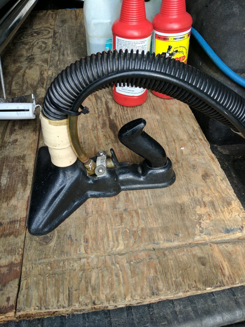

26,930
used my Ron Toney upholstery tool from over 20 years ago. I'm told it was the prototype for the hydro kinetic. A little crude but still my favorite tool for large, flat upholstered surfaces. Unique valve allows you to leave the trigger on if you need to. Internal #2 jet flushes great yet leaves the fabric almost dry. Great for office dividers.

The type and color of plastic he used reminds me of bakelite. Pretty crude fabrication but hey, it's held up to lots of abuse for over 20 years. Very comfortable to use and a flick of the finger, the valve stays open for production cleaning.
