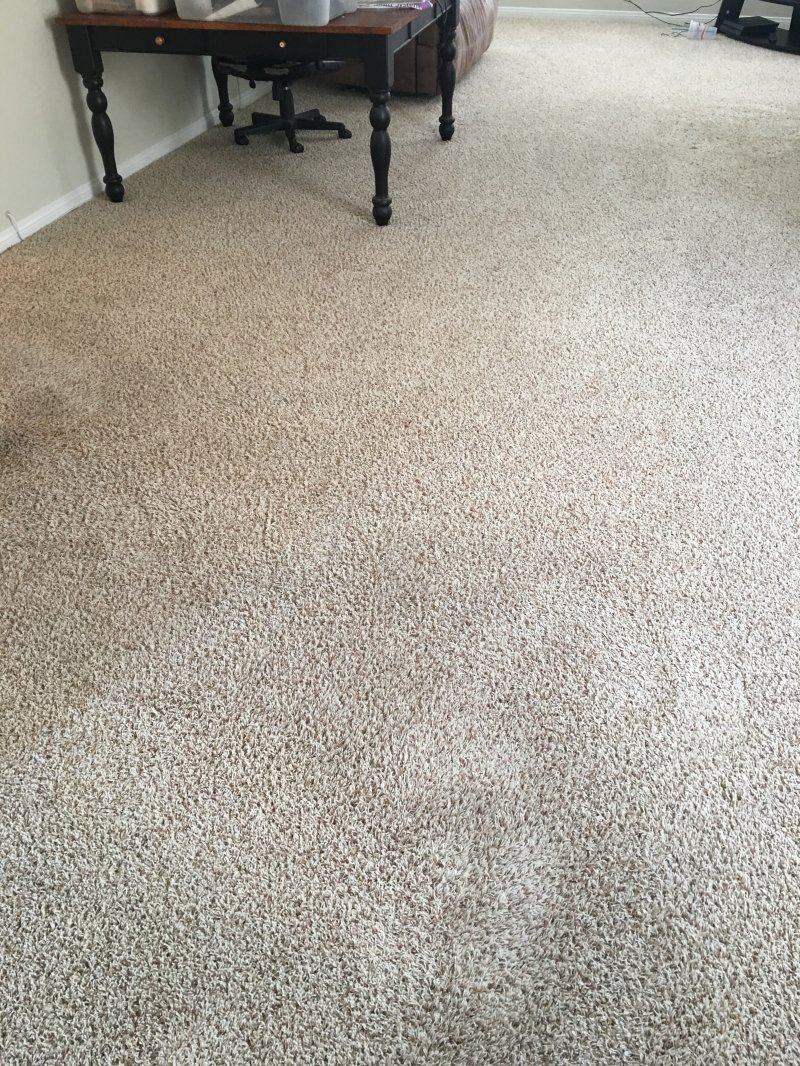

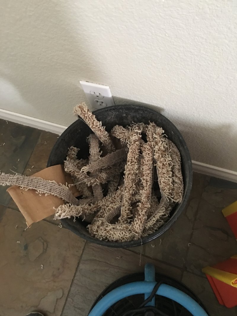

Did a whole house cleaning and some stretching for $$779 today 5 hours, and I got a bucket of scraps to.
Boy does restretching a Home Depot install suck!
I feel like a one legged man in a ass kicking contest.

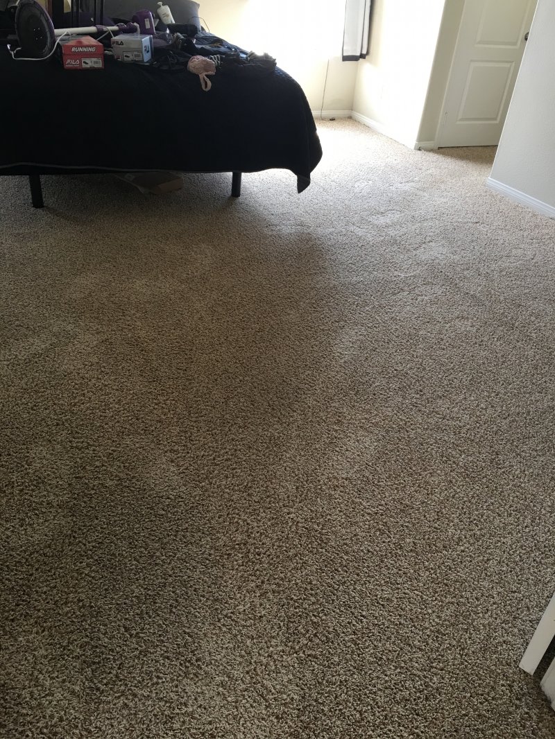

I dont know how unless its a really easy empty room with no closets lol. How did you do it with furniture still in there? do you just pull it away from the beds leaving them in place?
Use sliders.

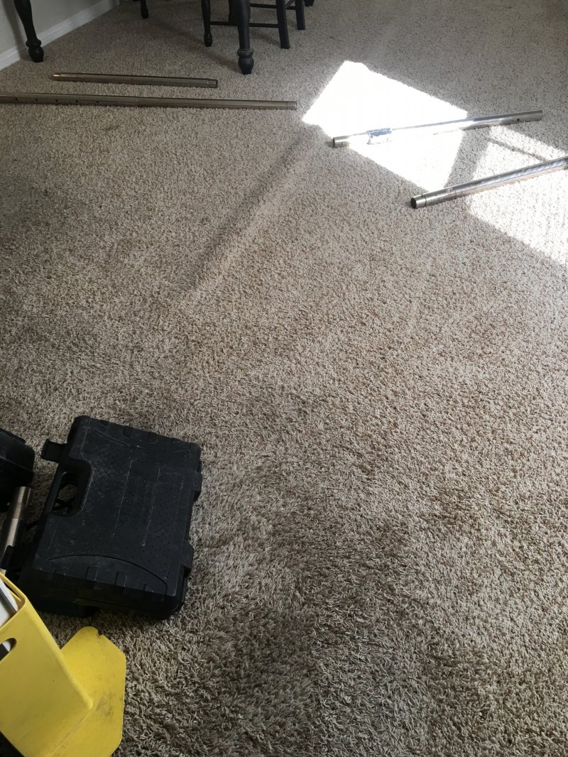

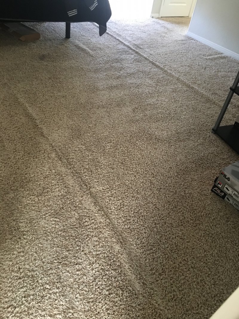

I usually request all furniture out if possible, this one had some easy pulls with a kicker then power stretched the opposite direction.
Also opened a hall seam I just pulled it apart by hand, not a good install at all.
Power stretched towards seam locked it in,
Then I kicked from the other direction and used some nails into the carpet through the plywood to hold it while I trimmed it and reseamed it up.

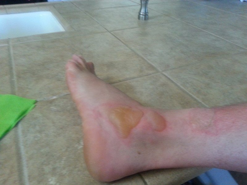

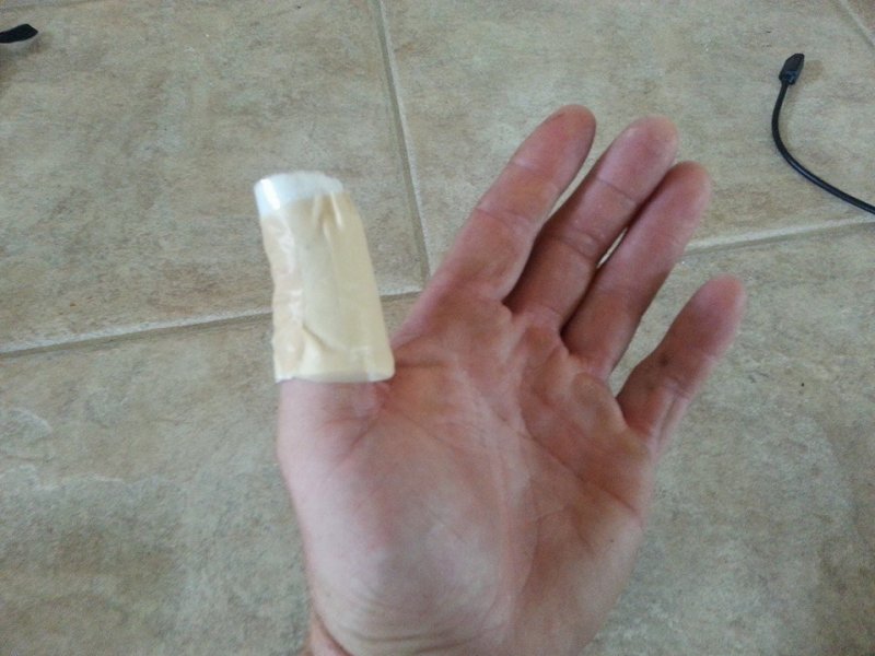

The day I found out my 2001 Express 3500 loaded with 2,ooo pounds of equipment could do 95 MPH, was the day I was driving myself to the clinic due to a repair gone horribly wrong with a bloody mary. Cut my thumb right down to the bone. Blood spurted across the room.
The second picture is when I burned my ankle with steam. I just uploaded it for sympathy.

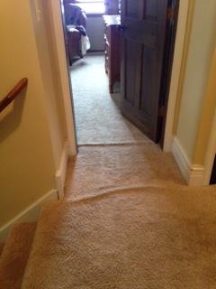

Mrs Finklegroover thought my quote of $150 was too much for this job. She said "I had one like this taken out before and it took him only 15 minutes."
I kept my smart assed comments to myself and stood by my quote. We just cleaned her carpet and she passed on the stretching.
