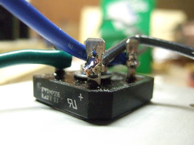

Sorry I wasn't clear. The pump will run faster not slower. You need the rectifier like Larry Cobb said. The rectifier is about an 1 1/4" square. If you look at the four terminals on it, one is marked with a "+". Some time that terminal is designated by a notched off corner. That is the positive side that goes to a wire off the pump. The second wire off the pump goes kitty-corner to the first wire. The other terminals get the 120 power from your cord through your switch. I don't understand the vibration comment except it could be that he feels that the pump motor is so old the magnets might be ready to break. How this helps.

Telly;
If it is the DC pump motor we use, it shouldl only draw about 3.5 amps.
We have them in at least 50 Century 500 PSI machines and the failure rate is about normal for a pump application.
Here's a photo of a rectifier I found on Google:
There are 2 AC inputs &
a (+) and (-) output terminals.
The amp draw on the 3-stage vac will be about 11 amps in series connection.
