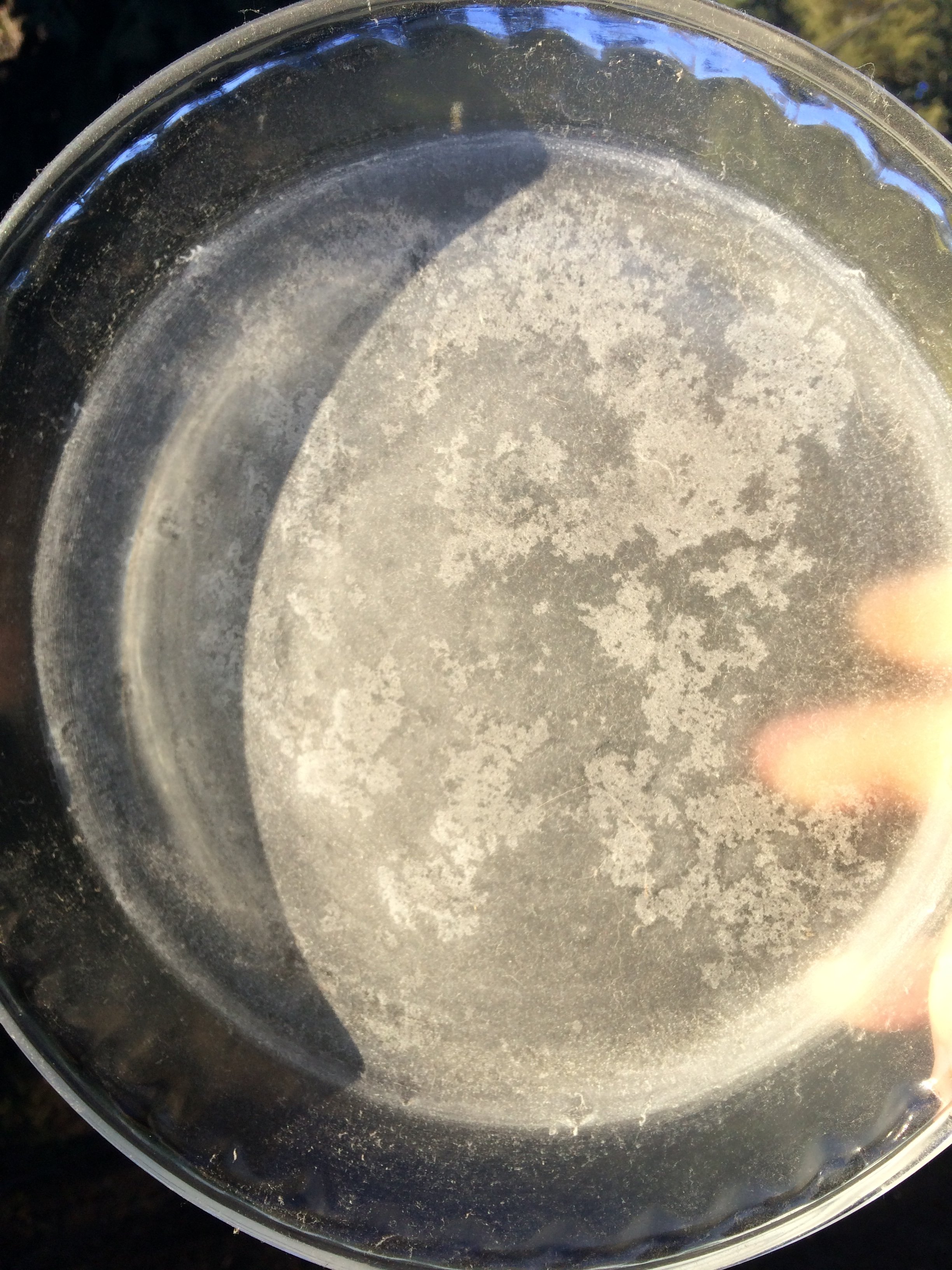

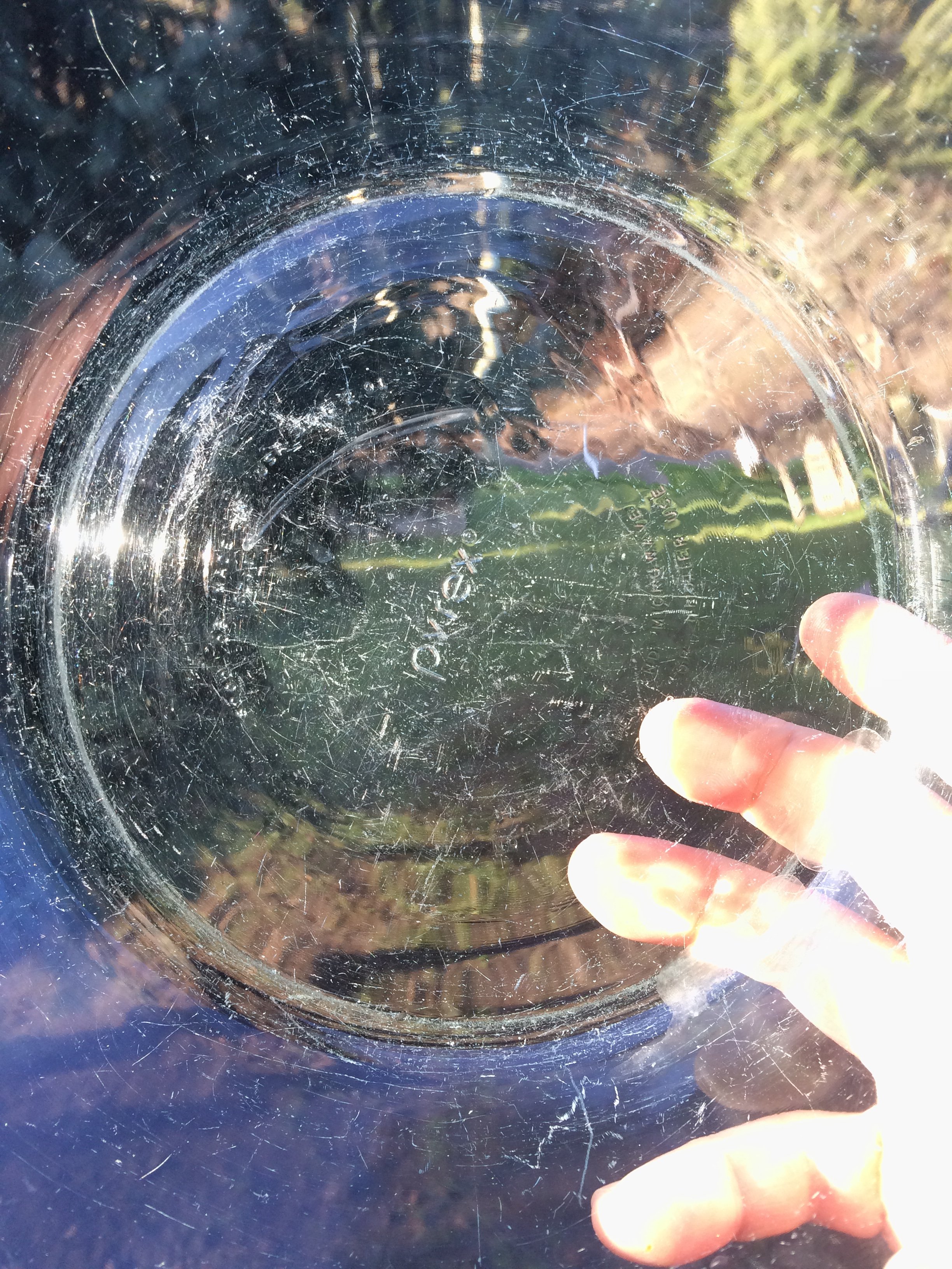

Ok Sam, here’s the difference between regular tap water, and RO... 2 cups measured, left on top of my deep freeze for a week.... just a little disolved solids in regular tap water? Wonder who is getting the carpet cleaner, with 1/5 the amount of chems?.....

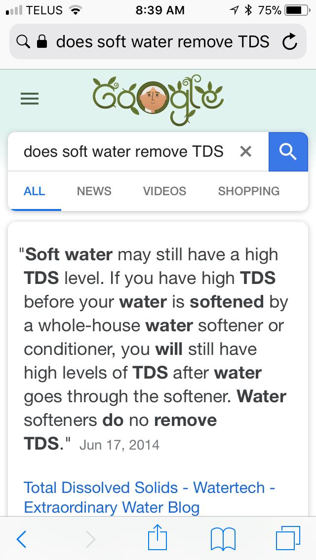

how about with softened water?
Mike, take a pair of glass pie plates. Use a measured 2 cups (500 ml), take water from whatever source you use to fill your TM. Then go buy a bottle of AquaFina bottled water (filtered by RO), pour one sample into each plate. Let sit for a week. POST YOUR RESULTS HERE, so you all don’t think I wear a tin foil hat.

And remember this.... none of us use 2 cups to clean with... more like 20-60 gallons on a house.... now multiply the TDS by how much water is used.... and people wonder why they get crunchy carpet, and browning....
