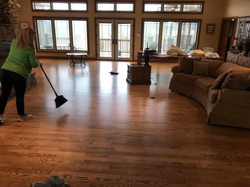

Well, we did the best that I know how. The Cleanco is in the shop today so I loaded everything in our trusty Honda Odyssey.
I used a product called "Squeaky" to clean with a 175 and a white pad. Mel collected what little liquid I was leaving behind with a microfiber flat mop.
We went back over it with the 175 again when putting down the Bona Hi Gloss polish.
Again, Mel and I smoothing it out with flat mops.
It shined up pretty good but wasn't exactly uniform, like I expected.
This is before we started. Mel has some during and after pics that I'll try to post later but this gives you the space we were in.
I don't believe you need to polish the Bona. I think it is better just to apply with a flat lambs wool applicator. I am going to be quoting on a similar job and plan to tackle it the same way you did, except with a Spraybog. Not too soiled, the Sprayborg is more for show. I am planning to use a white pad for agitating my cleaning solution and switch over to a terry pad to absorb it all up. I will take some pics if I can and see if there is a difference by not polishing.
Reactions: Russ T.

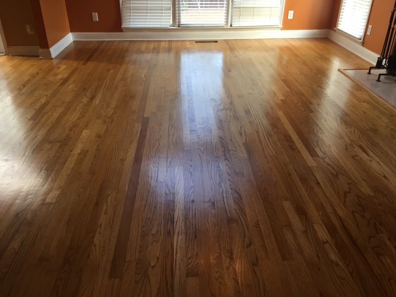

img_1907-jpg.71131
This is Pallmann "Pall-X 96" which is a non-yellowing single componant water-based finish. The floor was dull and very worn. This happens to be the satin, but as you can see it has a very nice soft sheen, not dull at all.
Dried, it is as hard as Kelsey's nuts. Retails for about $114, but at a wholesaler it goes about $40/gallon.
http://www.pallmann.us/products/product-search/details/pall-x-96-finish-1416/
