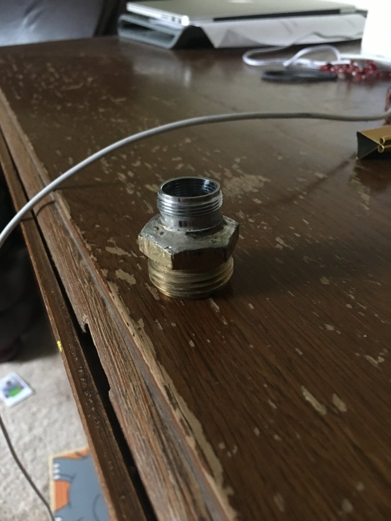

I soldered an aerator straight to a garden fitting for a hotel I used to clean for
