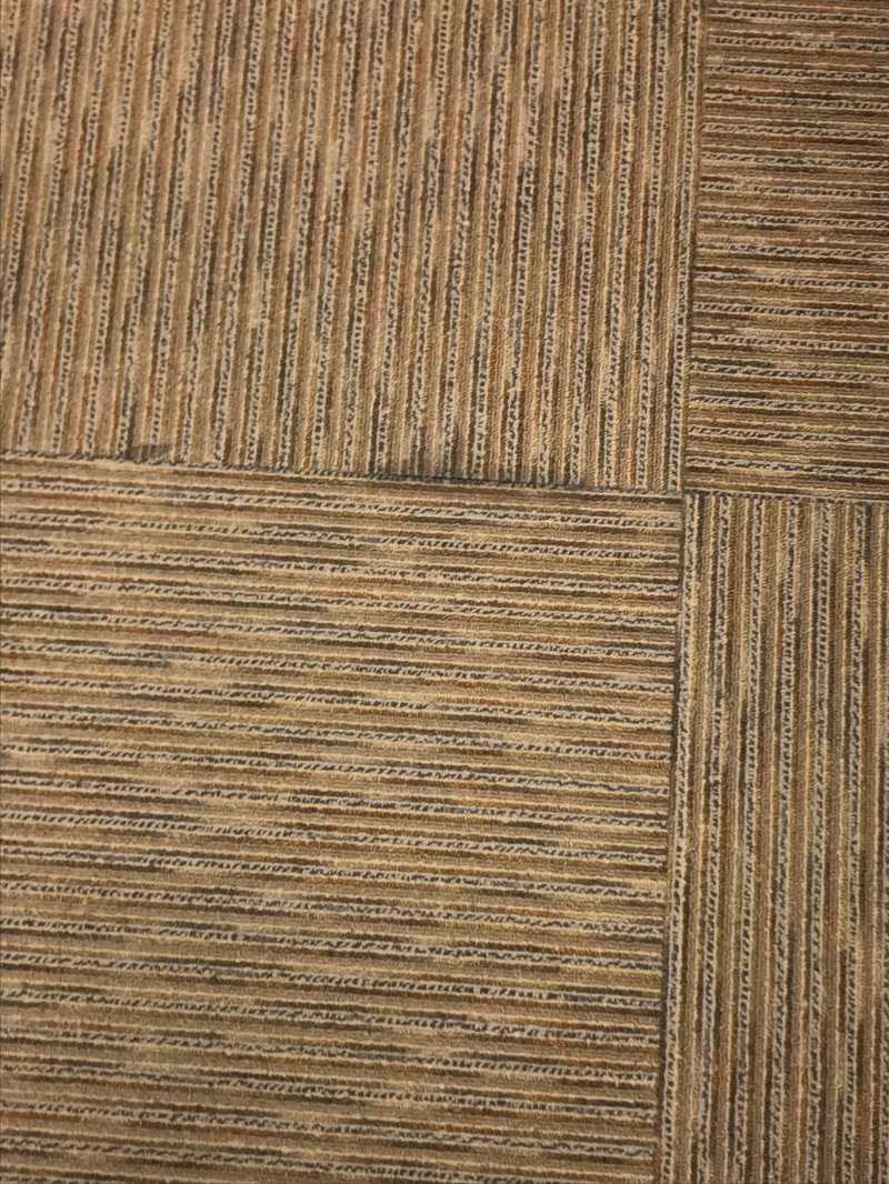

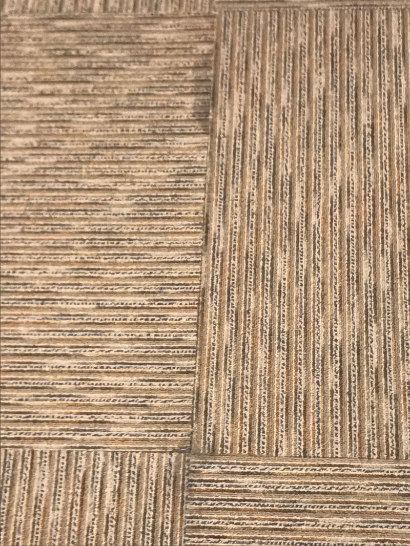

    Just measured a 9,000 sq ft. Law office that had their carpet cleaned hwe style about 3 months ago. They said a few days after the cleaning 20 different areas of this commercial carpet Tiles started to come up. Company that cleaned it used hot water extraction and when they called to complain about the tiles coming up, the company went back and put down some sort of glue that seep through the backing to the edges. As you can see in the picture below.
    I did not want to provide the customer with wrong information (even though I would have loved to describe why not to HWE) :) about why this could happen, so I am asking you... this happened because of improper installation of the carpet tile, or too hot of water used, or water left sitting in the carpet? It is in about 18 different spots where the tiles are coming up, the offices look fine, this is basically mainly in the hallways.

    The hot water penetrated the carpet, went through the backing and melted the glue upon impact. :oldrolleyes:
    Come on man! Poor installation. :arrrr:
    If it were from HWE, why wouldn't the whole install pop up? Same process was used.
    They should have called a pro installer for repair. NOT the one that did the original install.

    In that situation, normally bad installation and repair. Although, water can seep through tiles edge and cause it to pop off.. Happened when some one spill coffe on it like it did at a bank.. So HWE might be part of it.

    Do you know the history of carpet tiles? Pressure sensitive adhesive is used to be able to rotate them when they get dirty or spills.. The problem is it's sold high so people can't afford to have "extras" on hand to rotate them out..
    Getting back to the subject at hand, installation would be my ASSumption..

    Poor install did allow some moisture in which caused it to pop up.
    Chances are that the subfloor still has some moisture in those spots.

    Time... the adhesive is going to dry out...the texture is going to be difficult to extract well for under powered/poorly balance truck mounts or portables so maybe it was left too wet.
    Waiting too long to get the carpet cleaned... likely the Cleaner thought adding a solvent into his pre-spray was going to help... something like that.
    Maybe they had tried to maintenance it themselves...who knows. Lots of reasons why this could happen.
