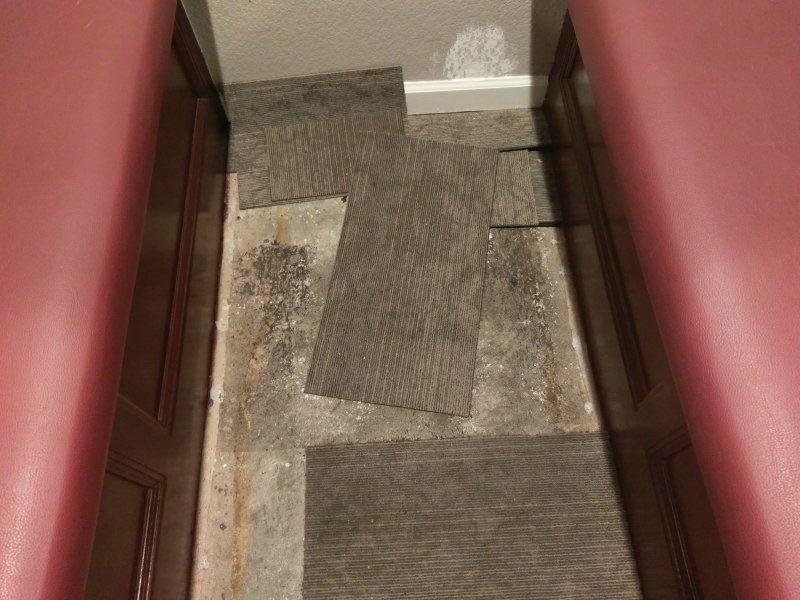

IMO-- Weak glue on carpet tiles installed on dusty floor is the cause.
Thats why the mill is telling installers to use better and additional glue.

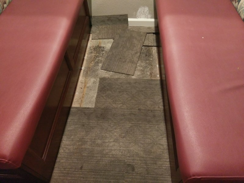

Carpet Tiles were laid a year ago, and are coming up. And we are encapping for first cleaning. But how could they be coming up with such good floor prep! lol
