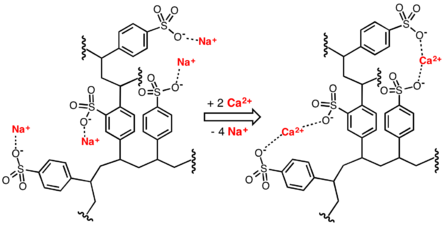

Water softners use salt to rinse the resin beads inside them. Not add it to the water. The salt is rinsed out with the recharging cycle.
The more water you use the softener the more mineral attaches to the resin. Salt that is used goes down the drain.
San Francisco, CA
Idealized image of water softening process involving replacement of calcium ions in water with sodium ions donated by a cation-exchange resin.

Yes, it's an ion exchange, but the water coming out usually has a tds of 20 or so, parts per million. Nearly untraceable amount of sodium. The salt releases the mineral that the resin catches.
