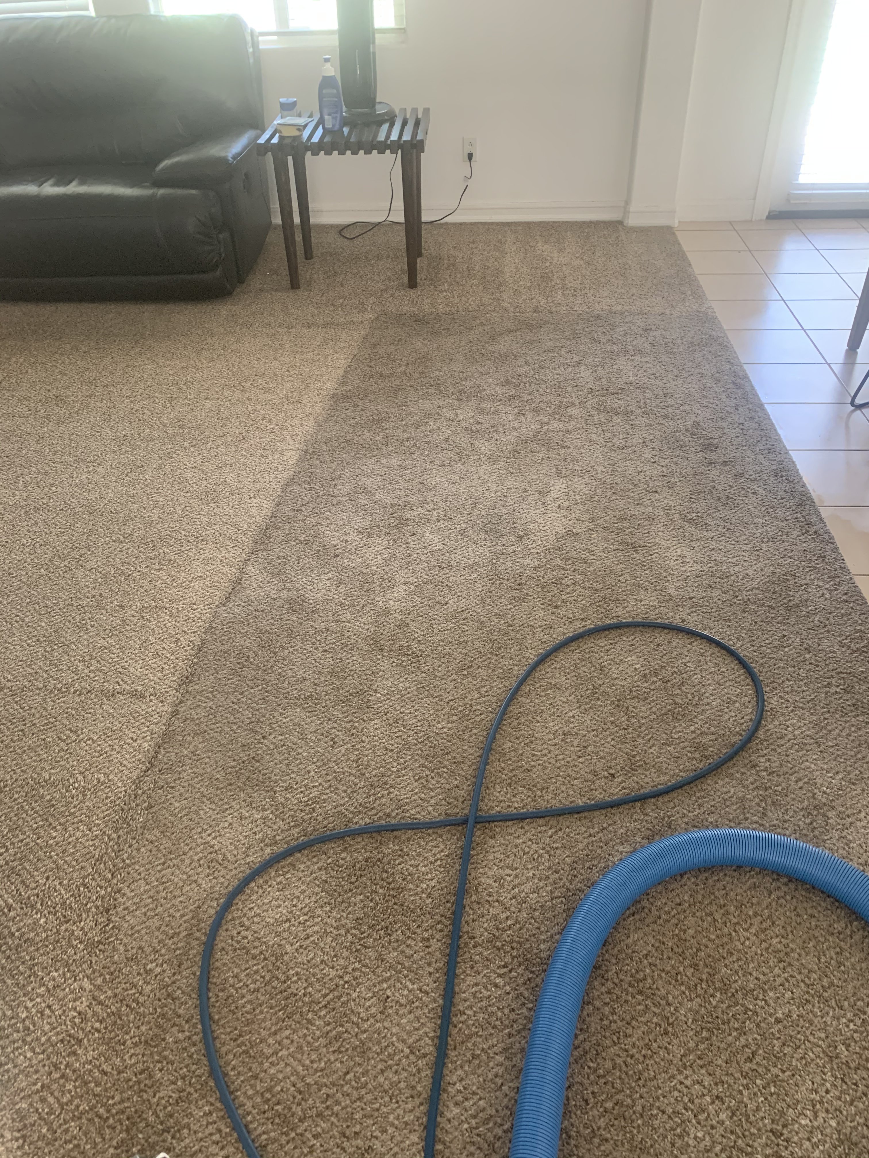

Hey I’m using an Everest trying something new bumped up my titanium sapphire wand to 12 flow!
Experiencing good heat and great results but
What are the cons? What problems can I look ?
First time adjusting jets so just looking for info from people that have experience!

Just make sure you're adjusting your vacuum to compensate for the larger flow. You want to make sure you are not over wetting. With an Everest, there is little danger of that as long your running at the appropriate rpm and maybe be more conscious of your dry strokes.
14,099
Georgia
Agree on moving the wand faster.
There’s no negatives to running 12flow.
