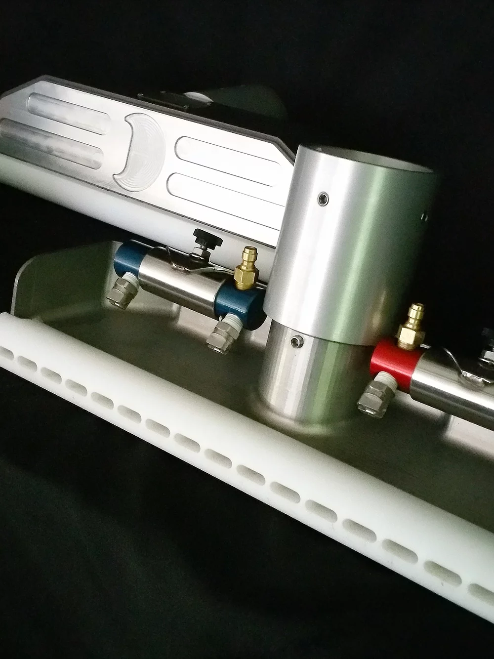

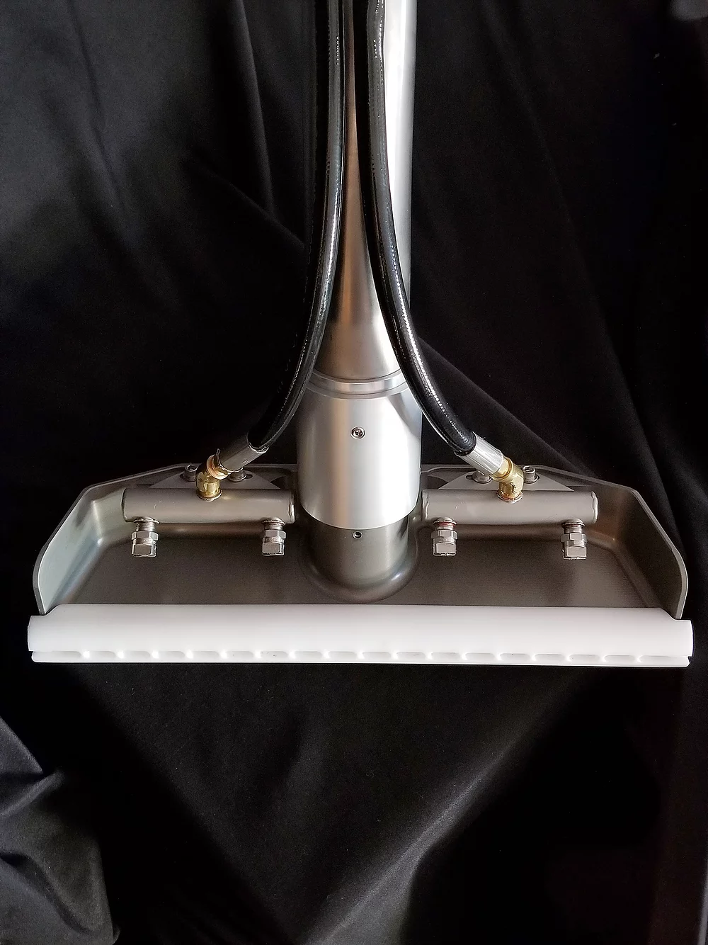

Anybody bump down to 6 flow (015 Jets)? Any problems with spray pattern, etc. if so?
I'm also thinking about buying the fixed manifolds and ditching the adjustable. I never adjust them and you can drive yourself crazy trying to get them perfectly dialed in. Thoughts?

You can drop to 6 flow just keep jets the same
95 110 110 95

drop it to 6...it will increase your heat....
My first one is adjustable......all the years I have been using it...never once have I touched them.....
got my second one yesterday for the employee...went with the non-adjustable....
