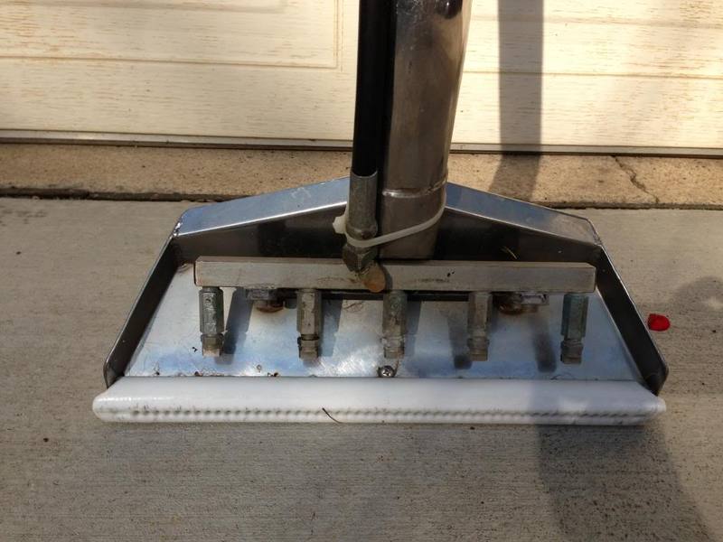

Can you post some pics of the backside of the head of the wand? I'm not familiar with Joe's kit, so don't know if it's set up like we set them up.
Also what is the angle of the jets? 02 is the flow rate, the numbers before that are the angle, should be like 95 or 110.

Yes, but you have a real Greenhorn manifold. he sent me pics of his and it is all kinds of jacked up, not a GH manifold, maybe Joe's kit, I dunno but it's messed up. I told him to put his stock parts back on and then we can go from there. This is what he has right now:

Yea, that's Joe's shear kit. I'll say ten hail marys and restore wand to stock. Should I try 9502s? Couldn't find any locally today.
When you get the pics with the stock stuff back on, I'll see what you need and send it to you. On me. I can't believe you've been using that wand like that.

Lisa has been helping me with my Greenhorn. I put all the original parts back. Ground the surface of the bracket that attaches the manifold for a little adjustment, but don't know that I will need it.
Lisa is sending me 9502s for the ends and some check valves.
