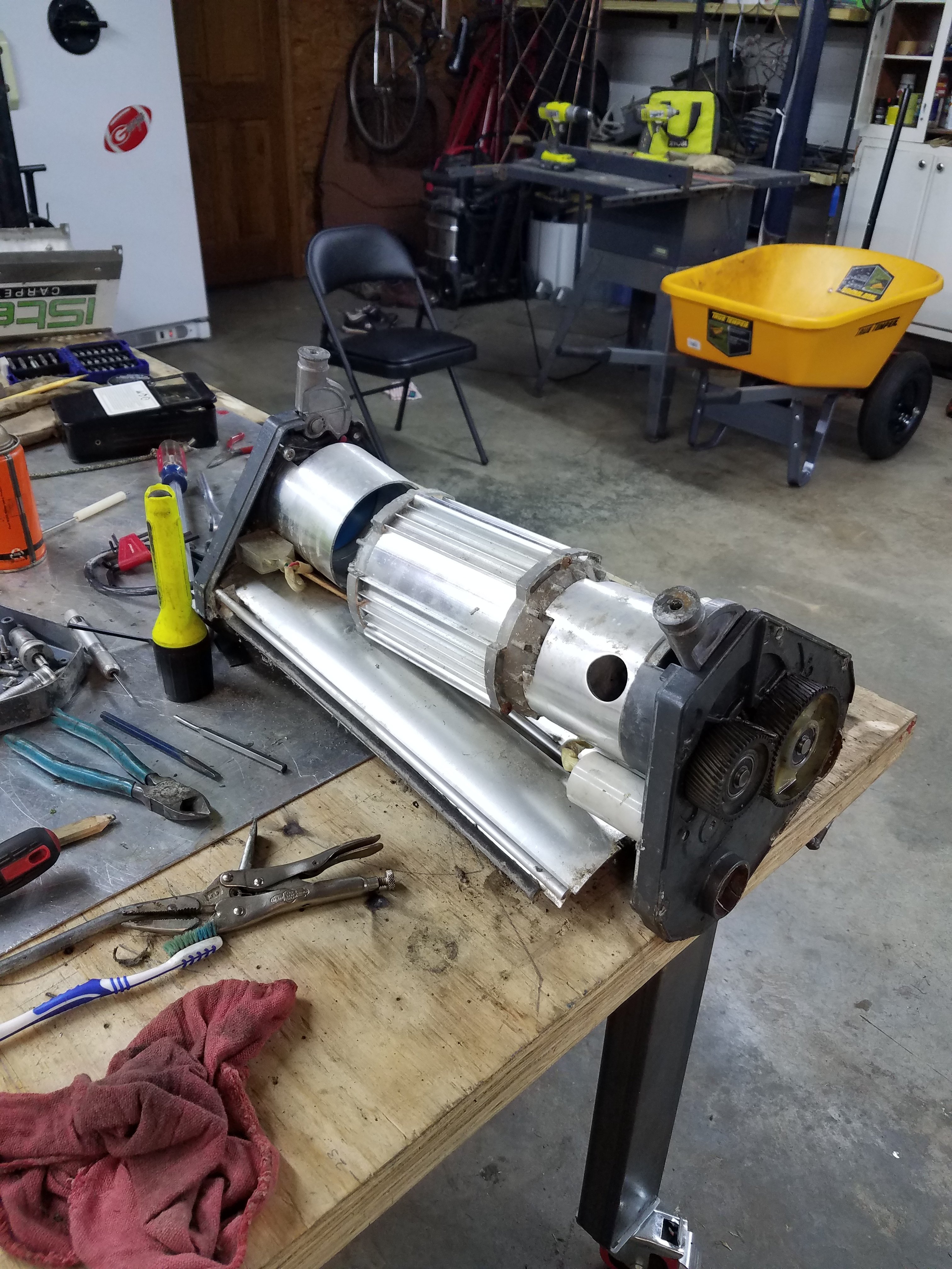

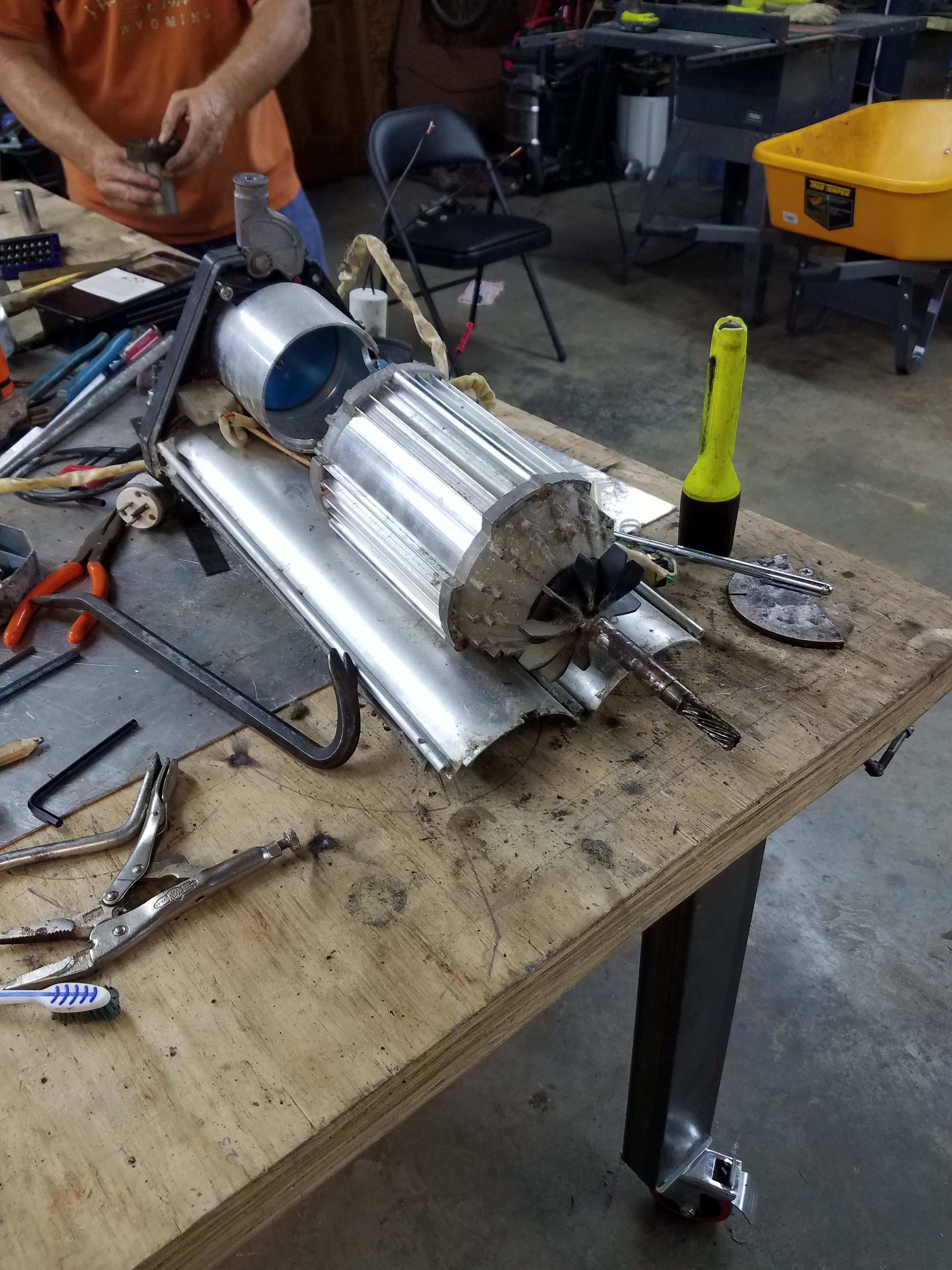

Had to go all in on tear down.
Could not get gears off pulley shafts.
Most of the screws had to be tapped out. Inside dust covers I wanted off to clean.
Hope my friend and I can remember how it goes together next week.

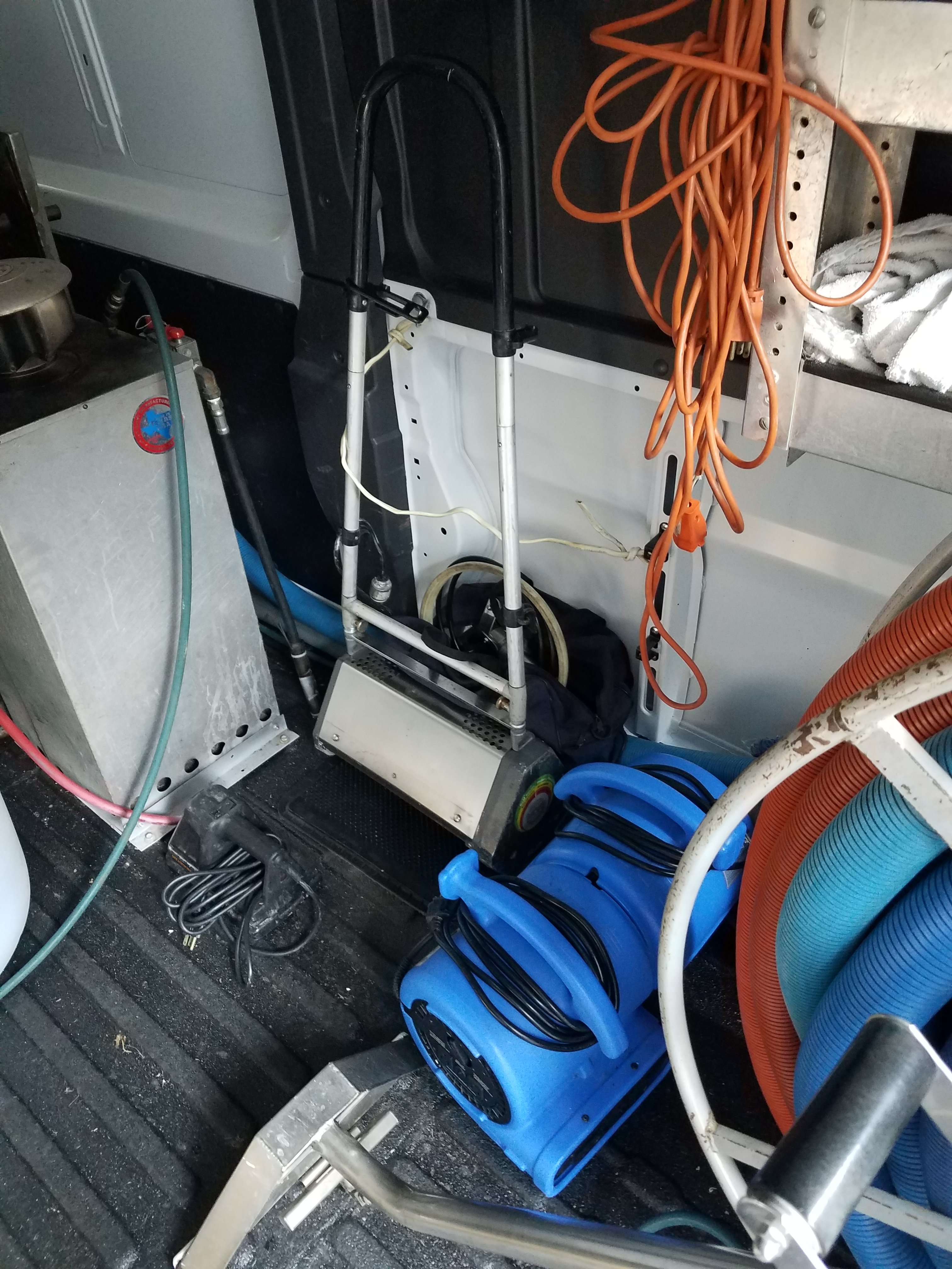

Update, The 15 inch is up and running.
This one is Austria brand name Strong.
Bought my parts from Whittaker Company carpet systems. Parts are the same. I'd say they just put the ID plate and stickers on them according to who is ordering from Austria.
Whittaker been around a very long time. Have parts in stock.
Also who Mikey and Saiger did video with. Carpet Cleaner America maybe??
Old Porkbutt showed me his Whittaker GLS way back on my premium pig ride along.
Using it on nursing home common area's tomorrow nite.
