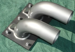

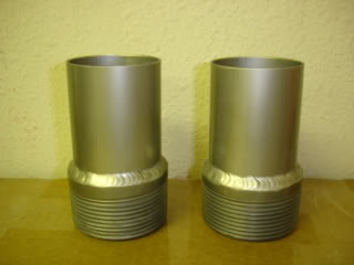

Those 47 class butlers have 3" elbows on the waste tank, and Butler uses a bushing to reduce them to 2.5", and a 2.5" plastic combo nipple (barb) for hooking up the 2.5 hose.
Recently we made a more streamlined 2.5" thin walled combo nipple, I think I will use this in the future to replace ALL plastic 2.5" pieces.
pic:
also the 2.5 dual elbow for the old vortex
R
R W
Those are some really cool inlets, built well, and install easily. The Genesis elbows are simular, if not the same. They contribute most of the improvement on the Genesis air flow, in addition to the 2.5 hose. If you want to use just 2" hose, the cuffs slide right into the elbows.

I think I'm gonna want 2 of those 2.5 nipples in a while.....I just hate to know how much they cost though. Not saying they aren't worth it or anything.
