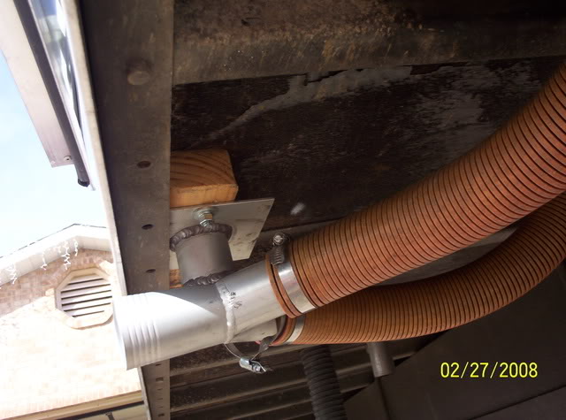

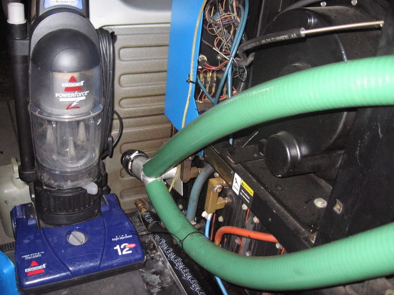

Doug
tman7 said:
Is there any noticible difference between running a y coupler off of two standard hose ports and a 2.5 inch opening ?
you mean like this???
This is the tank set up i have....so just adding a 2.5" is not viable
makes a HUGE difference
