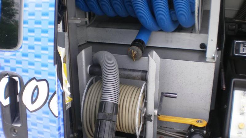

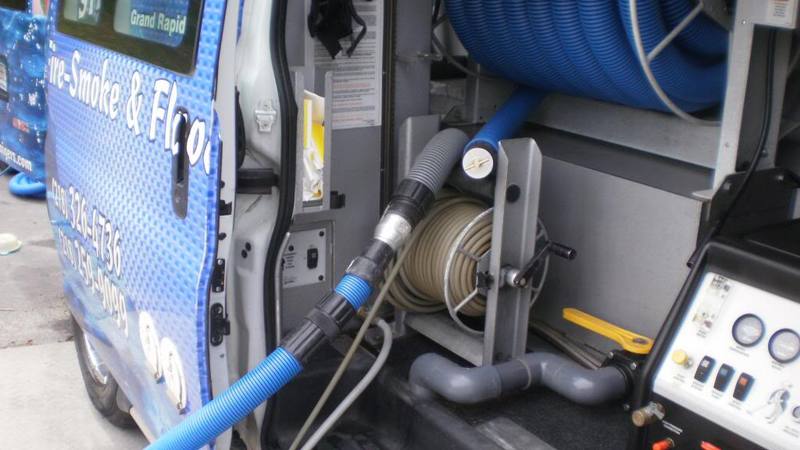

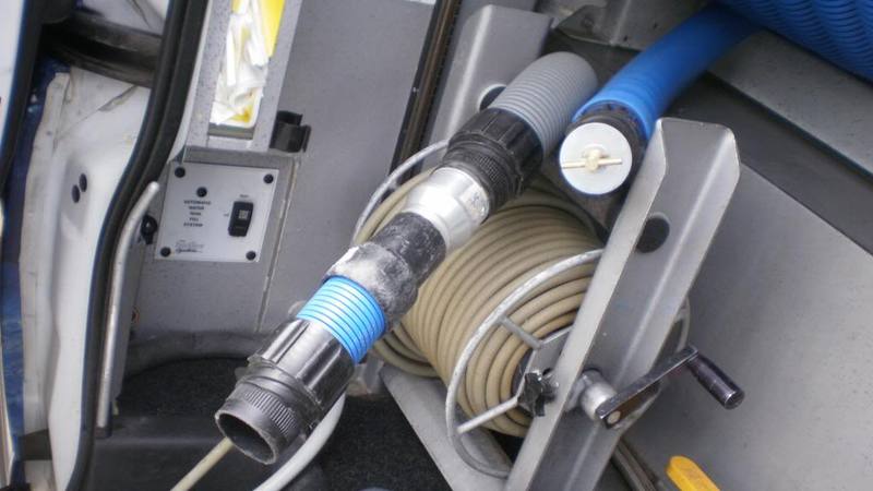

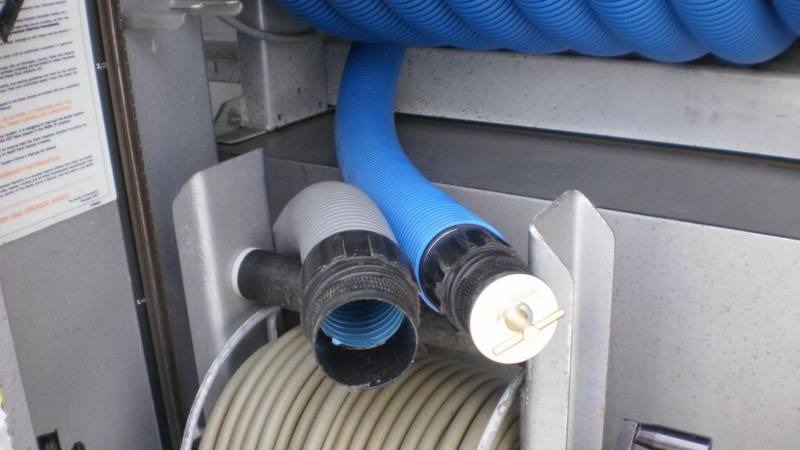

I have 2 Butlers with 2.5 inch live reels. The live reel will hold 100 feet of 2.5 inch hose. I have my 2.5 inch hose split into 25 foot sections. I have a "Y" splitter behind the hose reel. This "Y" feeds a short section of 2.5 hose to the reel and also to another connector in front of the tank. I only take off the live reel what I need at the time and then plug the rest of the hose on the reel off with a Shaw plug. It is a very convienient way to have more 2.5 inch hose available and still have a faster set up. I carry into the house my 2 inch hose. Sometimes if I only want to hook up 50 feet of less of 2 inch hose, I have an adaptor that can do that.
But as the guys have said, a live reel with hoses coiled up on it is bad. I only use the live reel if I take off or unroll all 100 feet of 2.5 Inch hose to put to use.

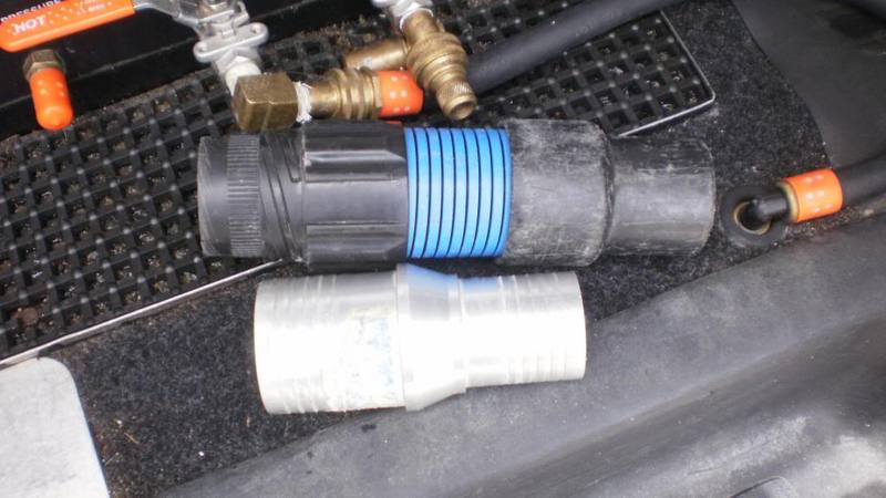

P.S. Mark: I know you are not using Cuff Lynx,
but a 2.5" to 2" reducer is inexpensive and would flow better:
http://www4.cobbcarpet.com/zen/index.php?main_page=product_info&cPath=72&products_id=4946

that's what I use..........so much easier then messing around with home grown parts.......
