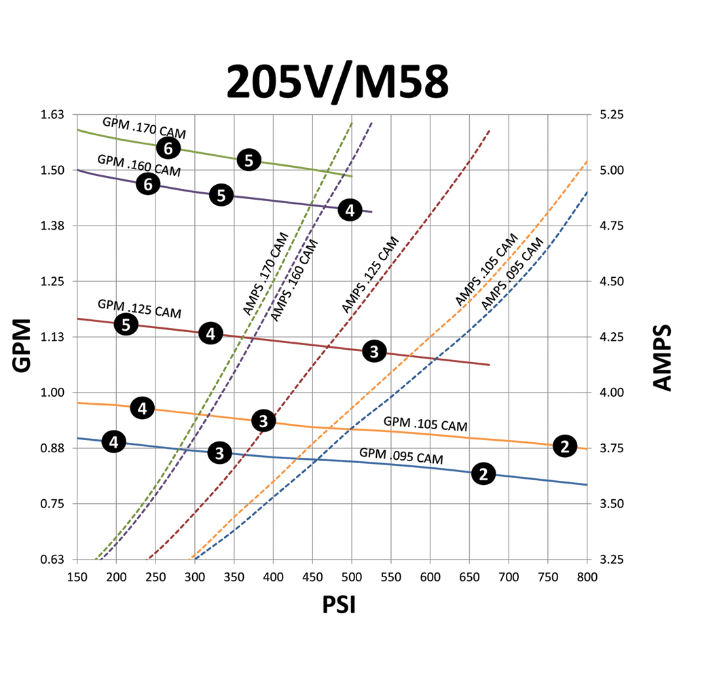

Agreed. Here's Pumptec's chart. The best you can hope for with the 160 cam is 1.5 gpm. You will experience a large pressure drop with any jetting above 04.

I think Pumptecs chart is correct, but the spec list is confusing, as they list a .135 cam delivering 2.21 gpm. which makes no sense to me based on the other components.
Proper cam offset for an M5/205v/M58 motor is 160.

I just spoke to Pumptec, 2.21 spec is OPEN FLOW, where the chart factors in jet/flow indicated by the black numbers (3,4,5) along the line.
