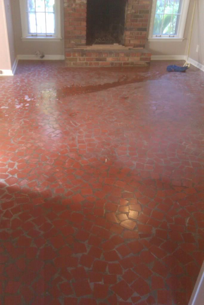

This is a residential broken brick floor that is level. It already has finish on it, but it needs a good cleaning.
Nothing to be moved.
There is one small area of wood that I was going to clean or just throw it in for 500.
I don't strip and wax much.
Is this decent, or am I way off.

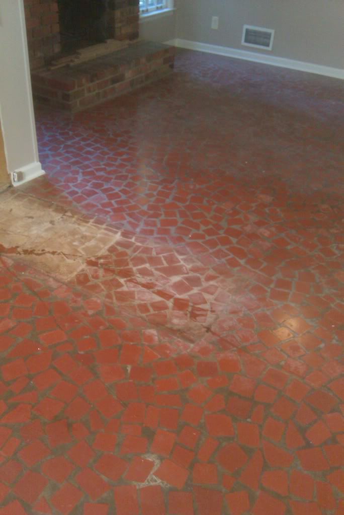

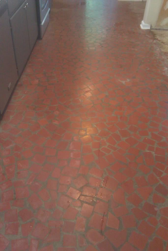

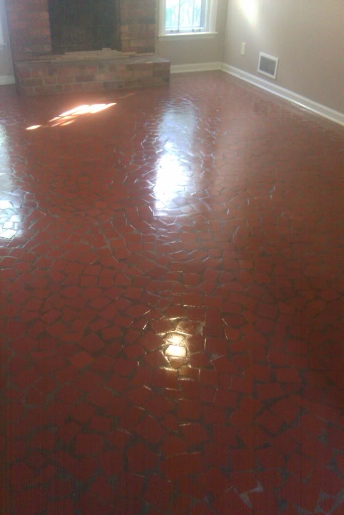

Broken tile floor. I applied pro strip 1:4, gave it 20 minutes to dwell, and scrubbed with black pad. I think a concrete brush would have done better. Everything seemed to be going fine. Then I rinsed at 1000 psi and noticed I was in trouble. There was a lot of wax that was not coming off. So I turned pressure up to 1500 which was better but still not good. Finally I turned the pressure up to 2800 and that peeled the wax right off. I had to change filters three times. Two coats sealer and 4 coats finish.
The Everest saved my ass! Just want to say that anyone that buys a tm that is not high pressure or dual wand is INSANE!

Re: 325 sq ft strip and wax. Is 500 good, too high, or too
not to shabby...
BUT
using a $25,000 wet vac????
why not clean it up and reapply the stripper??? There are jobs even with my equipment, you just have to do it 2 or 3 times
like i said...looks good....but while you stopped the "chunks" the liquid/slurry is what could screw it up
So, was $500.00 good money for you?
2800 PSI blowme
I’m with Doug. I don’t care to use the truckmount for this type of work, it just happens to be the biggest thing in my artillery . That job as not even close to worst case scenario. Removing dozens of coats of old finish from an uneven surface can be a bitch. I think the golden ticket would be a weighted CRB with really aggressive brushes.
