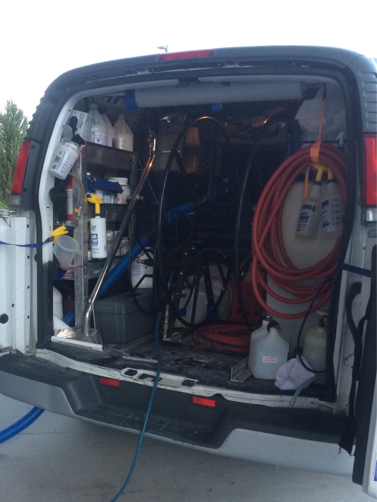

300 went out here : )
On a Fortay Seven, lol
