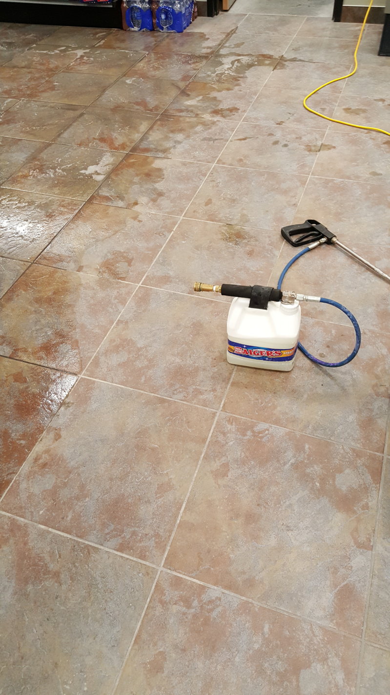

3300 Sq ft of tile and grout.. Come now!
11,200
Brand new gas station opening up.
Construction debris all over it.
They need it cleaned up now. So I'm heading there now!
Plan on using the Rotovac 360 XL tile and grout head and make some quick money!
6 p.m. and I'm on my way!
11,200
2 vans...
And houston we experience some difficulties...
Dang painters had paint overspray everywhere!
I originally thought it was just sheetrock dust and other debris... Ugh!
:hopeless:
11,200

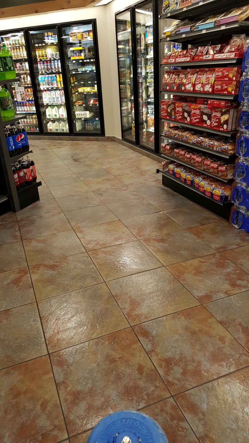

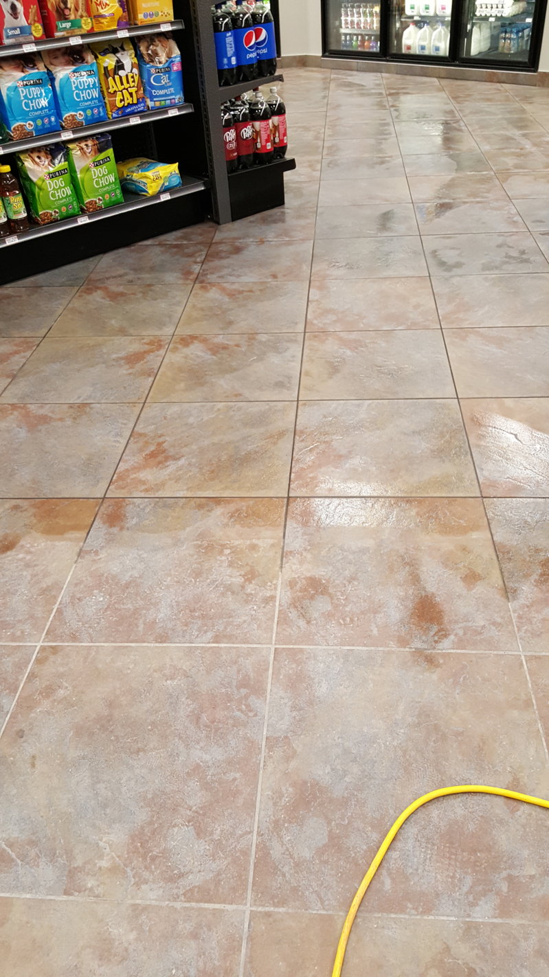

We came unprepared really.... Lesson learned again!
When went to look quick today, I assumed was just all sheet rock dust.
Ran into paint overspray (3 guys in there apparently spraying and not covering all the floor...
Some grout haze too...
Paint in the grout lines (as well as on top of the ceramic)
Forgot pads, drive block and should have had a heavier scrubber along...
Again, showed up to a gun fight with a knife you could say....
