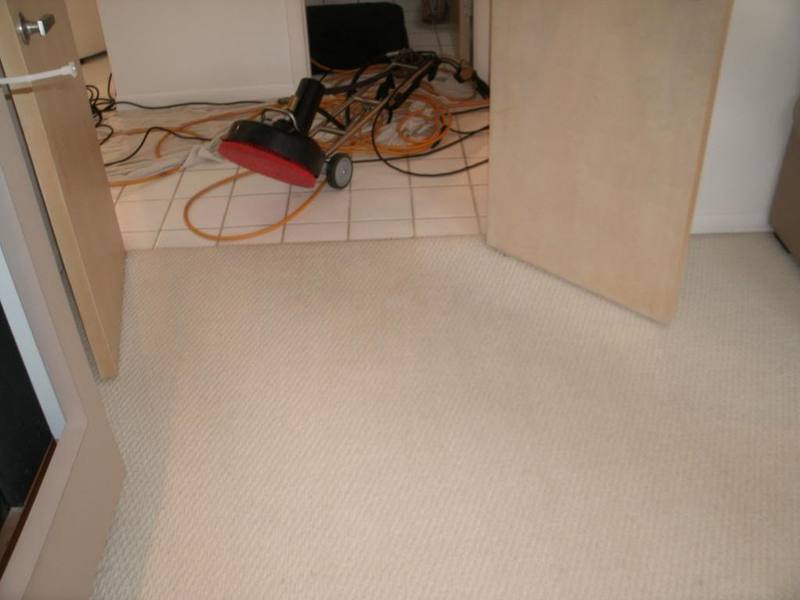

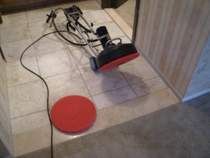

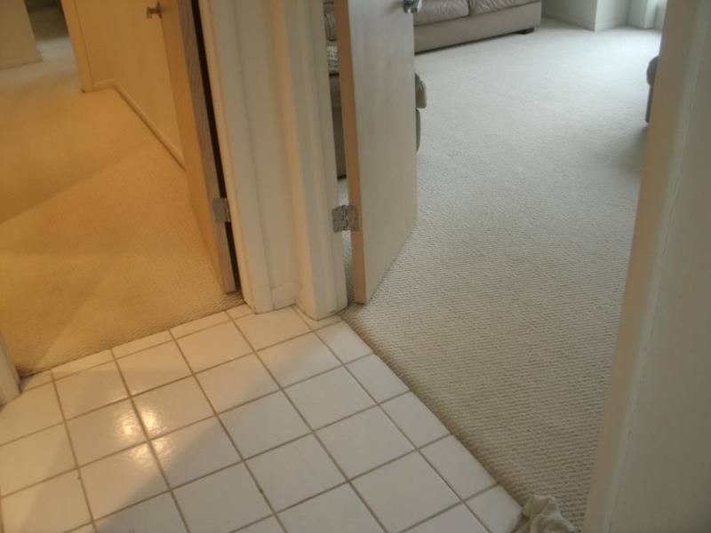

Crowley mentioned he used red pads for prescrubbing so I tried them with the pad driver on my 360i. Worked excellent. Sub 40# machine with 13' pads skims over tile and thresholds without damage, quickly scrubbed (12 minutes) 3 brs and stairs before extraction.019_zps8f5acfcb.jpg
Pad extends 1/2" beyond machine and effectively scrubs up to wall.

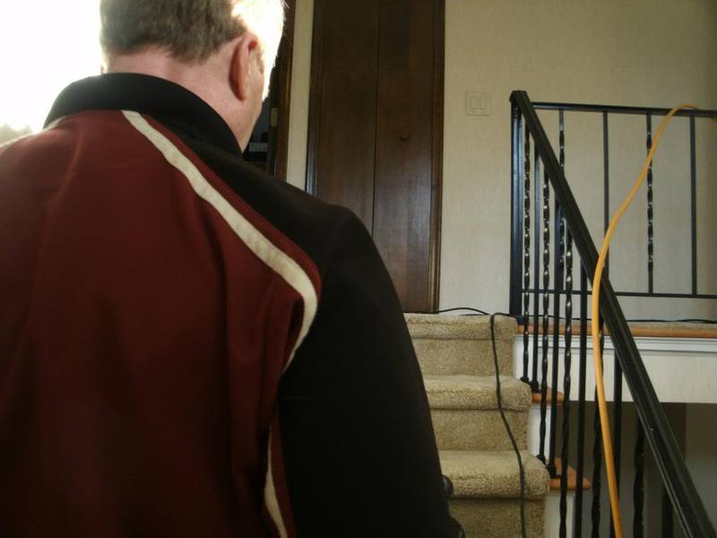

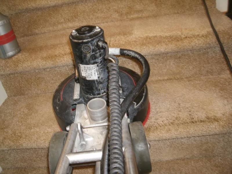

Collapse machine handles and scrub stairs. Pad stays in place. I usually use the swoop head on very soiled stairs, and nothing beats it. This is for light to medium soil.

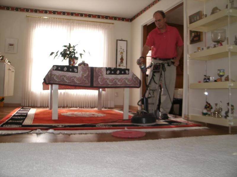

This pad thing is new to me as I always used brushes with the 175, but I find the red pad has a nice bite. I use the white pad very safely on delicate oriental rugs:

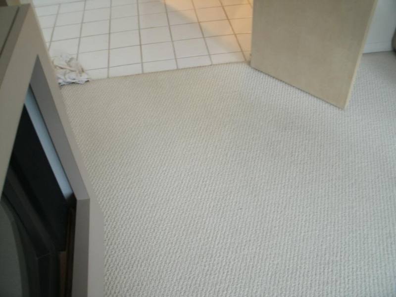

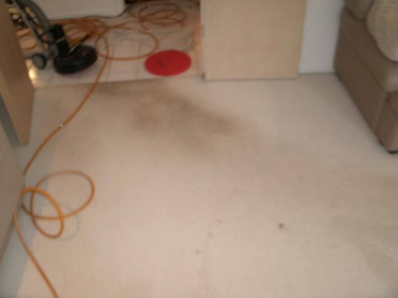

With the temps below 10 F this week, I did a lot of preconditioning with the HF hooked to the custys sink and a quick buzzing over with the red pad. This heavily impacted and dirty loop berber looked great with just this preconditioning:

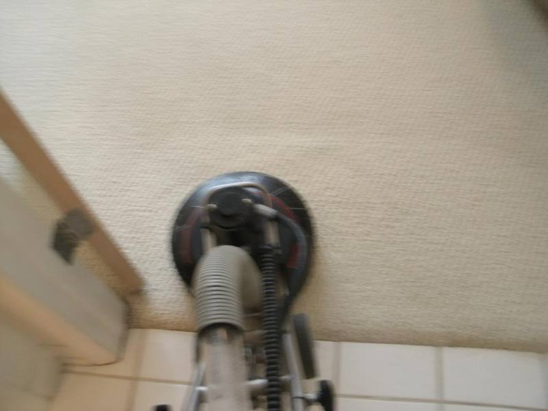

Then when I finally fired up the TM and ran the 360i it really popped:
