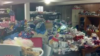

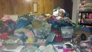

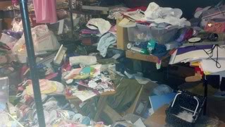

4-inches of water and way too much contents....WAY TOO MUCH!
They had a water loss Wednesday night, new hot water installed the day before and a faulty valve dumped tons of water. Four inches of standing water when we go there and contents from end to end and no where to go with the stuff, so we are in our second day of packing and sorting and tossing. Hopefully we can get to the structure later today or tomorrow. Carpet, drywall and paneling all need to be removed still.
You never know what you're going to find! ;)

I encountered a loss of similar pack-rat-itude. The restoration company that I called for the homeowner just got a roll off container and junked most everything. There were valley pathways between mountains of stuff that was just piled and piled.
We consider a roll off but really the stuff isn't as bad as it looks. She is a seamstress and most of it undamaged fabric, even of that some of the wet stuff can be dried and then decisions can be made. The panel, drywall and carpet will be bagged and our usual hauler to dispose of. Lots of questionable stuff, divan's wet at bottom only but older, hidebed that could be salvaged but mattress wet. Lots of clothing too, wet but ruined? Not really. Most will be dried and decided on next week when they send and adjuster down.

I had a job like that once..... but it was 10" of poo water instead. After shifting the the dry/undamaged stuff onto other undamaged stuff to get to the damage/non-salv stuff. We had over 57 hours of just content manipulation.
Yea you know how bad these are. This one is worse than most because there is no drain in the floor. They use a pump for the ac condensate line. How can they have no drain Connor?
No where to go with the stuff and everything will need demo'd, paneling is water stained 6-inches up and carpet and drywall need to come out, nothing to do but get all the contents up and out. We will probably have 100 man hours before we even start the demo.
