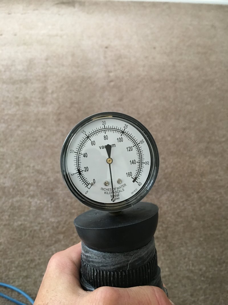

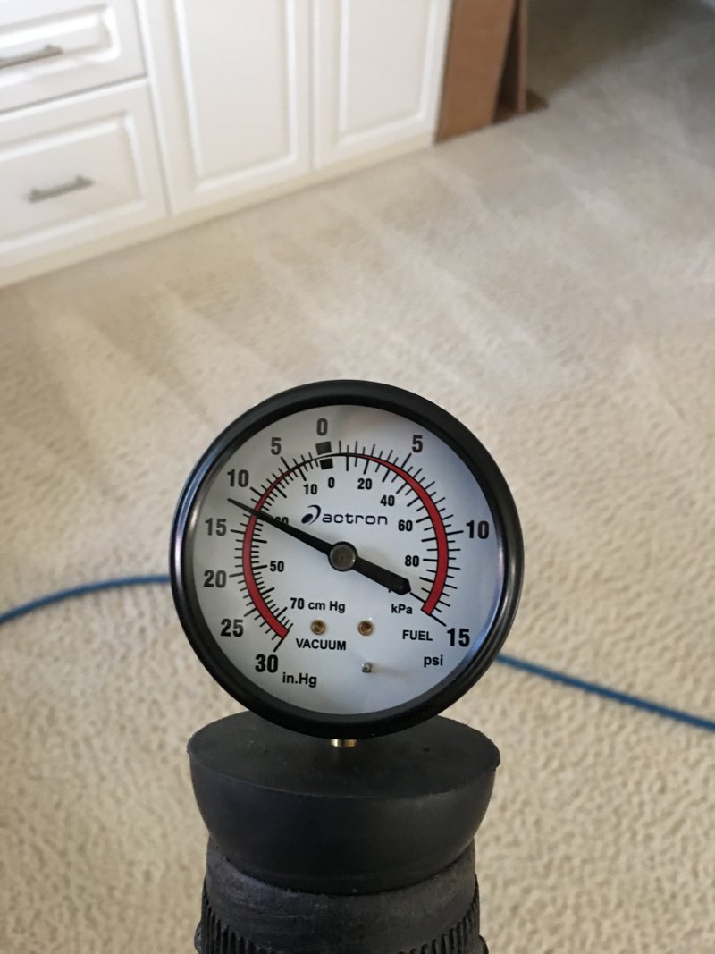

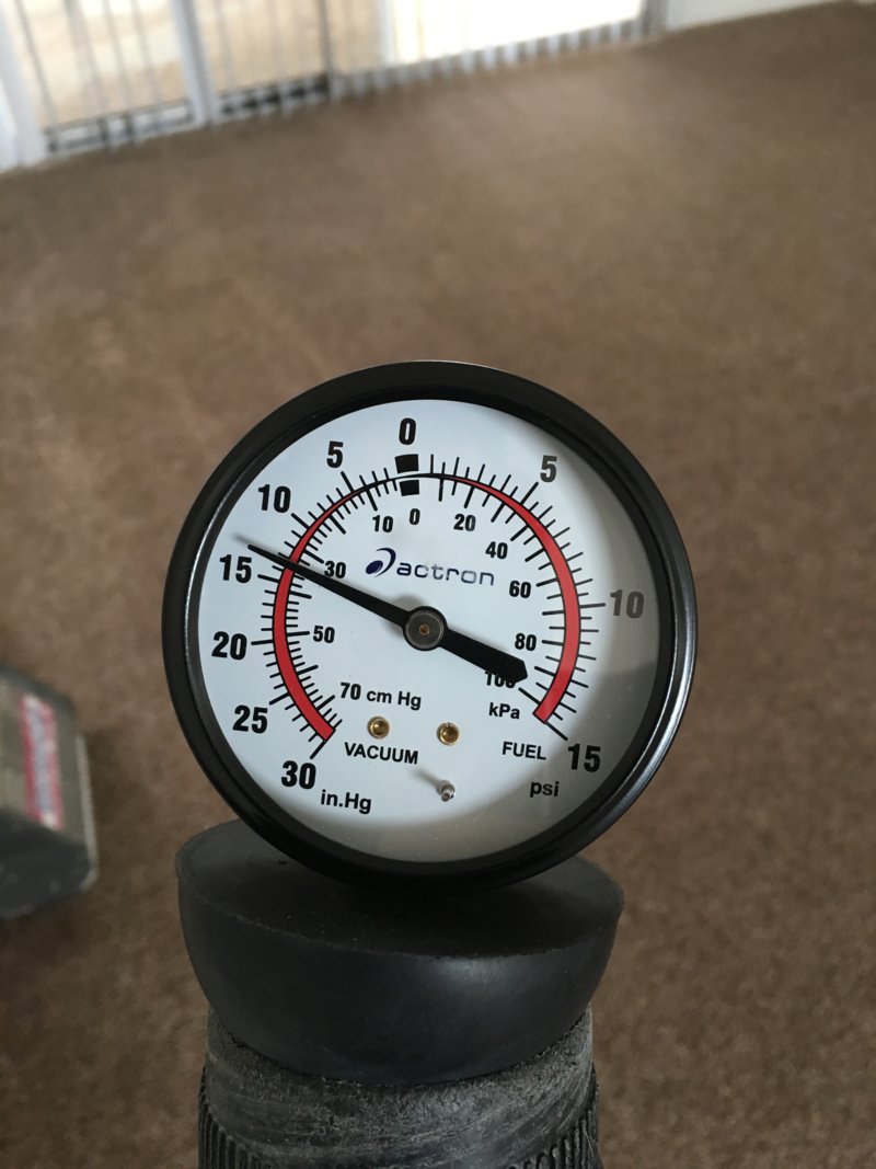

It's a little misleading because I could set my relief on my 570 higher but.
405 results 100 foot hose run 2 25 foot 4 to the door to a devastator filter 25 feet of 2.5 inch hose to 50 feet of 2 inch hose.
570 running 6 ft of 2.5 into silver bullet then 25 feet of 2.5 to 75 feet of 2 inch hose.
