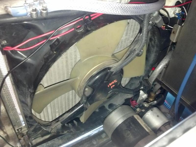

No the PC isn't dumping water, I did check that in fact not long ago I put new thermal v just for that reason but its not doing it now.
I may have the only vw that runs a radiator
