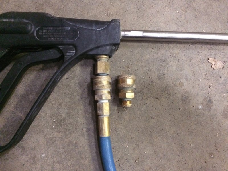

Newest version HF is kinda leaky around that quick connect. I'm falling out of love.
I'm willing to spend a little more on something better. Any suggestions?

Use normal QC's so you can also use the gun to pressure wash showers, your van, the mess you made in the drive way and the poppy seeds stuck in your teeth from your breakfast bagel.

Just ran in the same issue. Started leaking like an open faucet after a month of use. 86'd the QD and it works great, but it's a bummer not to have a swivel point there.

Yes, like Mike said. Put a normal 1/4" quick connect on.

You can replace the seal with a brown high temperature seal and problem fixed.
Mine have gone out a couple times and this fixes it.

I just replaced my quick connect (both male and female) yesterday .. sprayer about a year old

Yep, I'm on my third hydroforce in the past 2 years. One started leaking through the handle in the middle, another broke at the quick connect. One broke in 2 months, but to be fair, my supplier replaced it no charge.

Hydro-Force made a change to its valve and I am assuming they are having their Chinese manufacturer make them now. Only reason I can come up with why we are seeing such a high failure rate. Same reason got the QD. We replace those with USA made female flow through and they last 5 times as long as the ones they come stock with. Multi-Sprayer(Gene) is using real dema valves and everyone that has made the switch has told me they are getting way more consistency from Gene's then these new versions of the Hydro-Force. I know why Hydro-Force went cheap and had the Chinese make a copy but you don't take that risk with your flagship product. I wouldn't be saying even of this if they weren't blowing me off the last 9 months. I have asked and asked and even volunteered to come in and talk with them because it is a BIG deal and nothing but crickets....I'll post some pictures of them side by side here after lunch and they are on the list for Josh to get on the website tomorrow..
