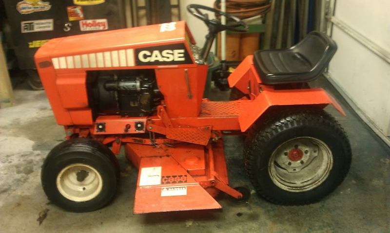

alright anyone know about the PTO's on the front of these Kohlers..
it's called the easy adjust...
but there ain't nothing EZEE...about it!
this tractor is 30 years old

ohh sorry..it's a 222....

OK...it won't open...
however the first problem IS:
the very front nut that holds the whole PTO together......
the manual sez it's a right hand thread (righty tighty)
but i have two Case (experts?) that say it's a left hand thread......
...it's on tight.....if i break the damn thing it's close to $500.00 for a new PTO.......

Tender touch of heat Bawb!
Got faith in ya!
U can do this Ol Man, nice and steady : )

my bad...thought the experts were saying standard threading...yeah..lefty loosey according to the vid

IT WAS GONNA BREAK.....i had a 3/8 ext rachet and a 3/4 socket....it moved....tighter!!!
lik i need to spend an afternoon extracting a broken bolt
thanks for the space Fred....i'll let ya know which way it was
