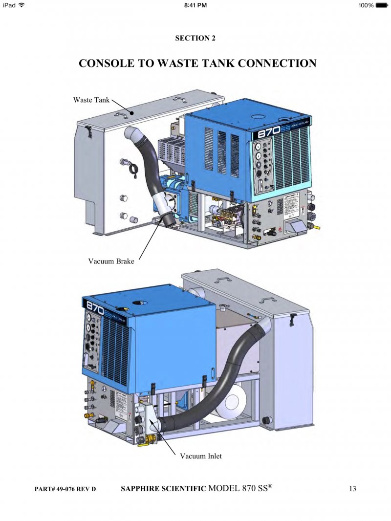

I really want to install Friday but I ran into a glitch. The tank is obiviously meant to go straight behind. I'm mounting it to the right of the machine. No way can I bend the stuff they sent that much. I thought all this time one of my suppliers had a flexible solution. Turns out it 4" inside also. Won't work. So my only option would be PVC. I can turn the fitting on the blower straight up and run PVC connected with the stuff they sent as a collar. At the tank I can cut off the down angle and then I would have a straight shot in. Ideas please
Do they use any kind of lock tight on that fitting. I remember how difficult it was the last time.
Gene

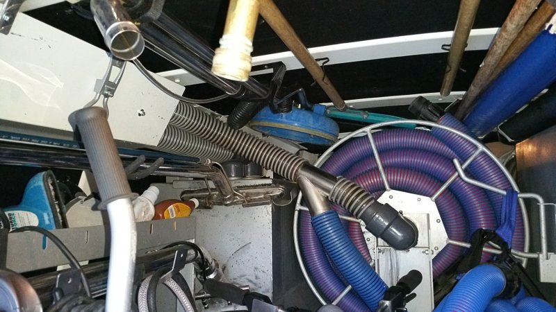

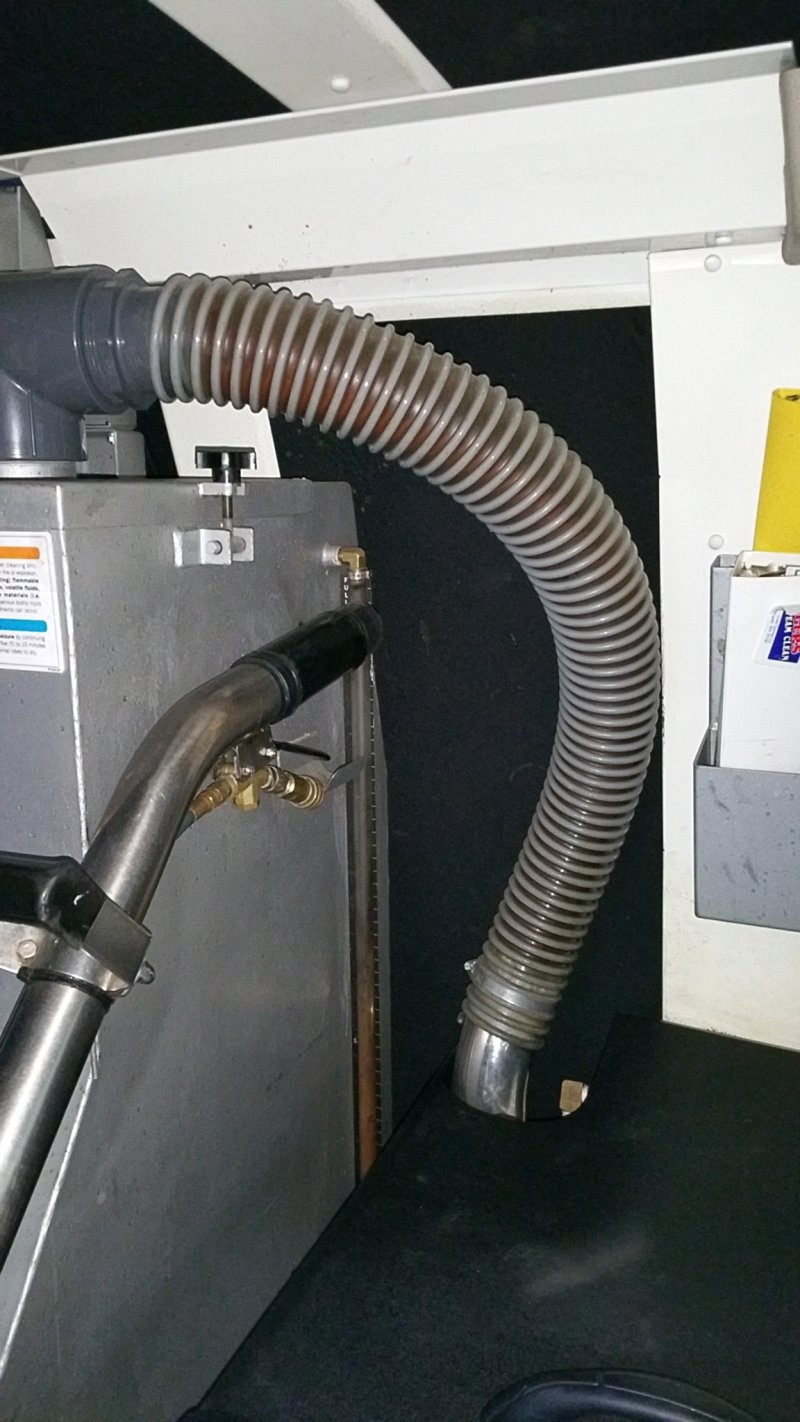

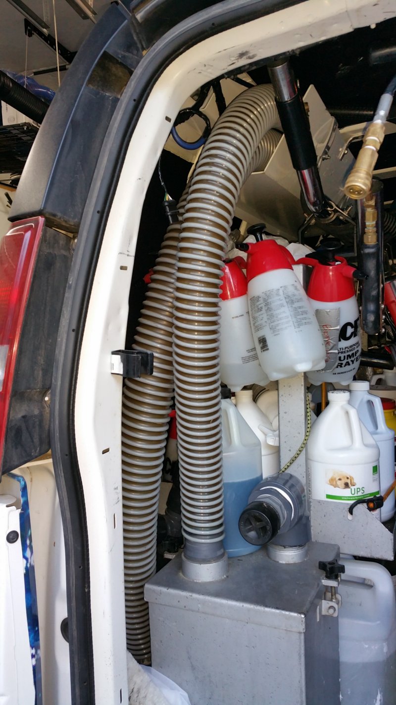

Here are some pics....
I would call Butler and Talk to Daryl or Matt and tell them you are a member of Mikey's Board and I recommended you call.
There are 2 different sizes it look like too....should get you covered....
