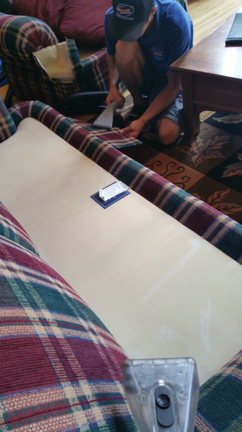

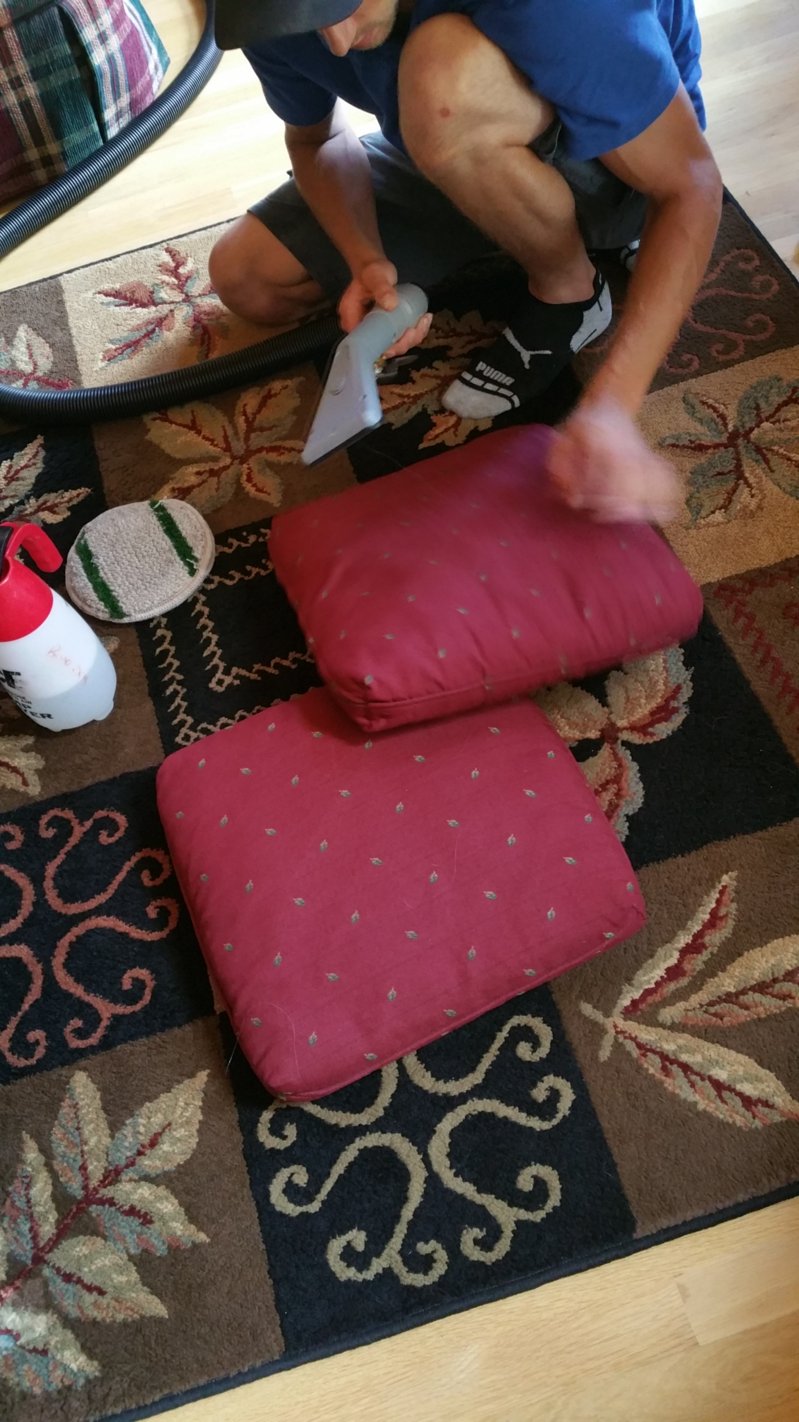

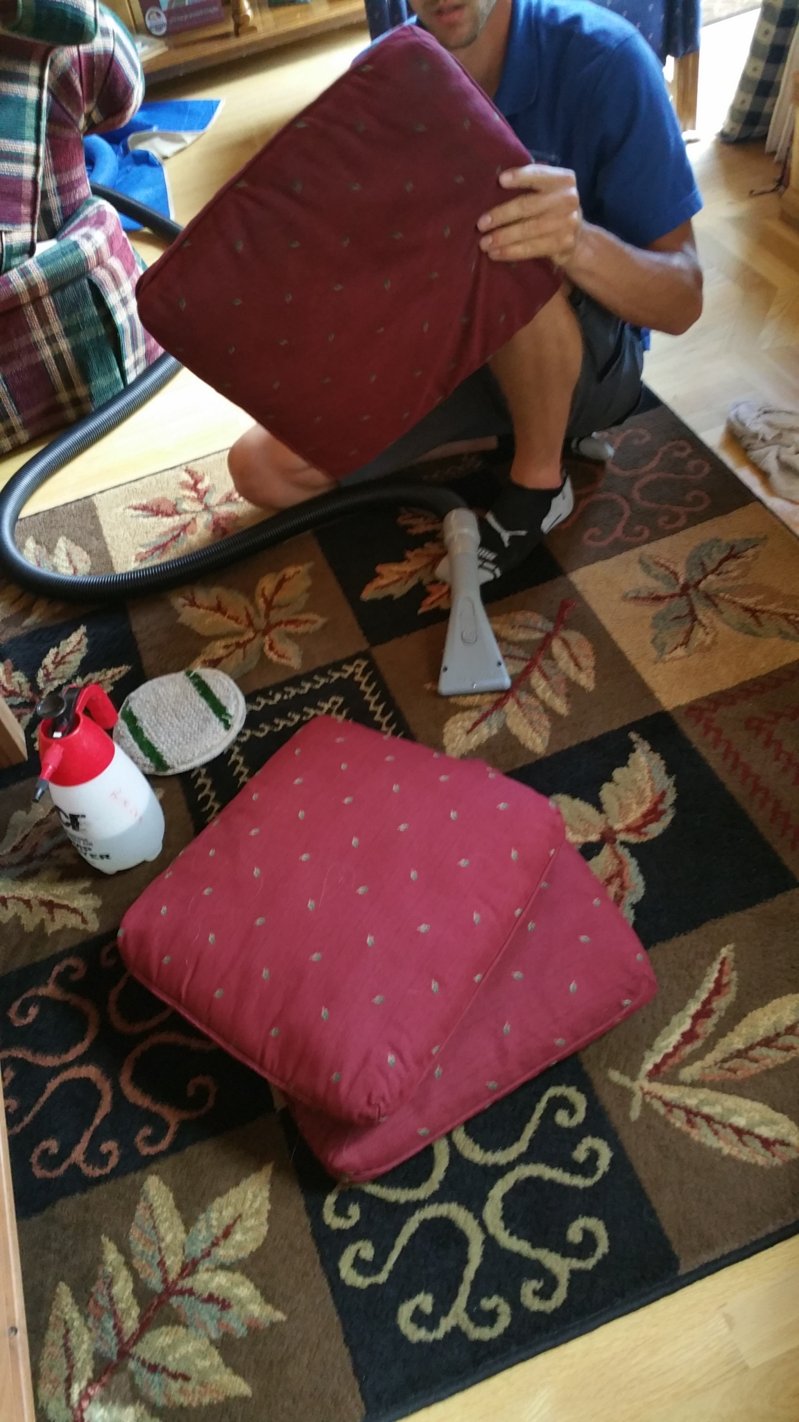

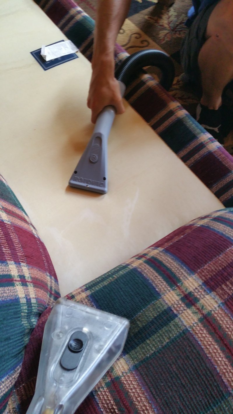

Actually dual wanded off one of our Butlers today....
11,200
Well....dual wanded upholstery....
Had lighter day as first 2 jobs had to cancel or postpone
First job called at 7 pm last night.....rental house...
Dog sitter over the weekend....and the dog ate the carpets....and some other problems....
Carpets getting replaced....'
Next job, called to let know on way....they were headed to the emergency room with situation....

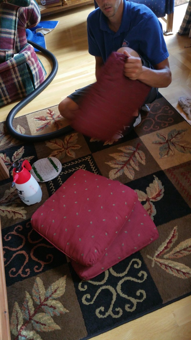

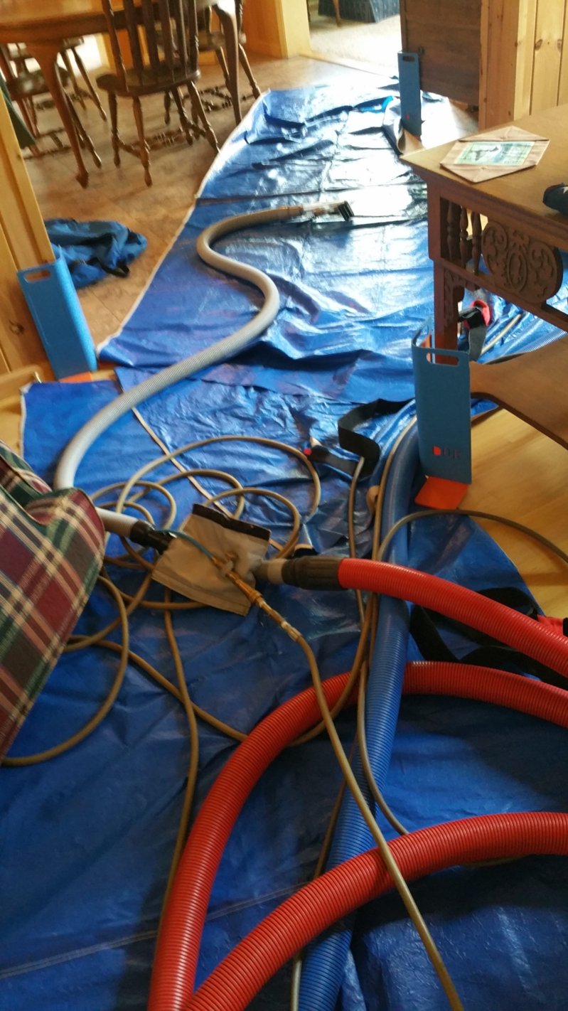

So next job 40 minutes out in the middle of no where....we decided furniture only....we will just dual wand off the butler....
2 love seats, 2 recliners, 1 couch....
2 different upholstery tools....banged them out quick! :rockon:

We always dual upholstery with our Butlers--I'm sure you could triple and probably quad if you wanted to. Tip to maintain better heat--nix the pressure hose reel and use a 50' hose from your console. Perfect heat for PMF internal jets.

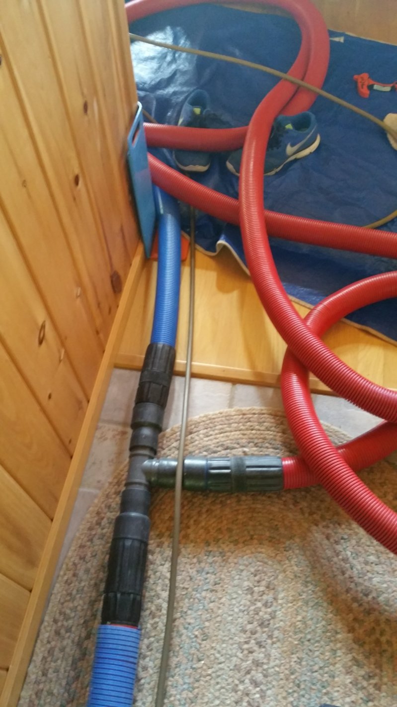

I thought that a T splitter would not work as well as it will not deliver the same even suction on both ends.
Always used a Y splitter.
Is it Minnesota different?
11,200
You are correct...T splitter not as good as Y splitter...but my only Y splitters were 2.5 inch, and I left every Y splitter back at the shop....
Long story....but this is what I had from an "earlier put together need something fast" moment and it was still laying in the back of the van....
My brother has my other 2 inch Y splitter right now too....
This worked fine for upholstery ....but would not use it otherwise....
