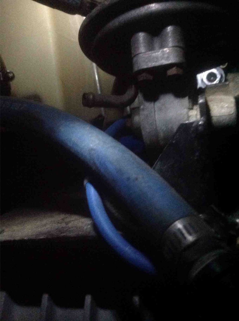

I pulled the old one. Unlike the new one I can blow in one port and put the other freely.
I will find out tomorrow. I'll have the pulley pressed on and I'll install it.

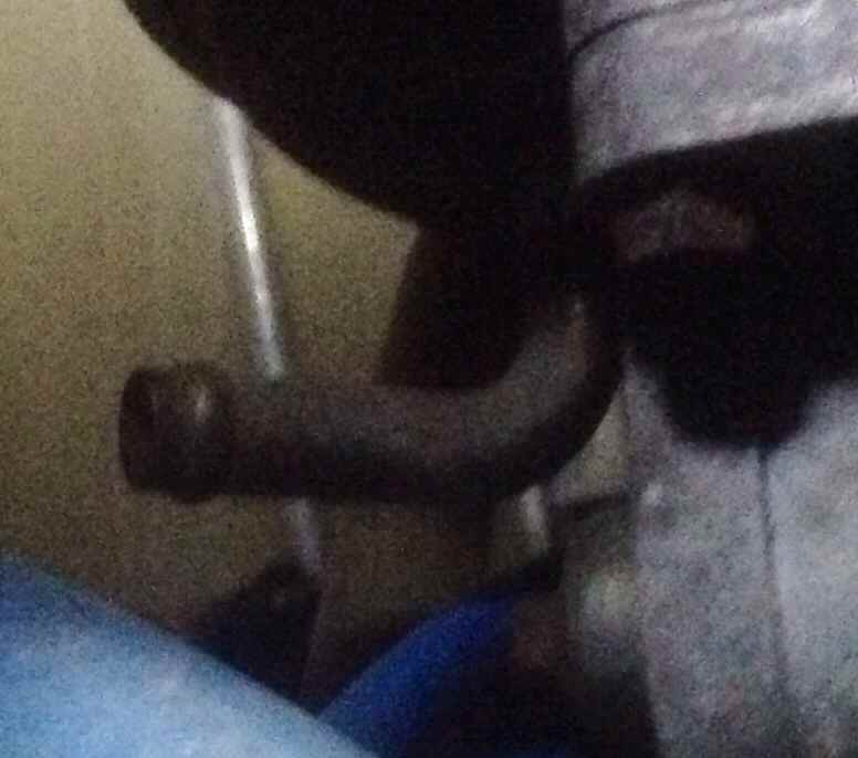

There are 2 ways start machine turn on heat exchanger that lets air pump push air thru elbow exhaust when its on you can feel air coming thru metal exhaust elbow. Also theres a little pipe facing down outside the air pump like a small tube if its working that will have a little suction on your finger if you cover it.
no suction its not working.
11,182
That little elbow should have suction when its on and working like I said if it has no suction you need another one.

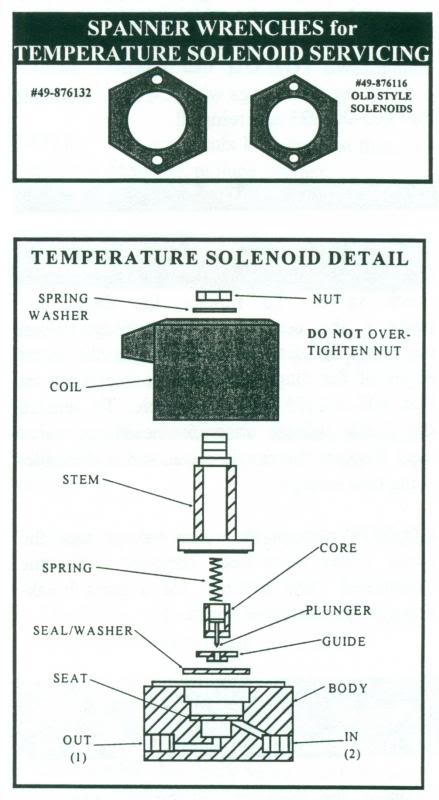

As far as it dumping, it's more likely the Temp Solenoid is what's bypassing water. All it takes is a little hard water scale to not allow the pin to seat and then you're bypassing water and losing temp. Remove the solenoid and clean it well then run a water softener or carry soft water. That high heat from the Cat will boil the water and cause you some scaling problems if you don't use soft water.

I think I replaced (2) bypass valves among 6-Performer over 10-plus years but Temp Solenoids were far more common the culprit when bypassing water was the issue. Take it apart with a spanner wrench and use little descaler and it's no biggy. Just be careful not to wallow out the seat, you do that and it will always bypass water.
