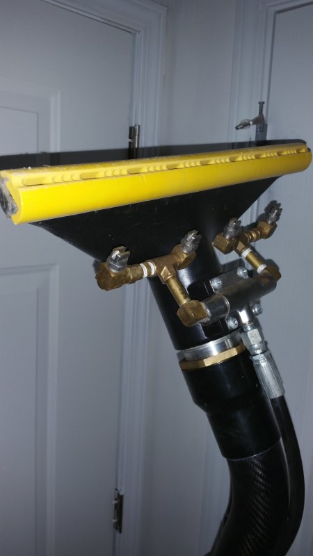

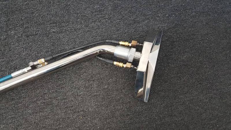

Here is one used on a carpet wand..
These never got popular for carpet for some reason. Either internal diameter restriction, sloppy play, leakage or durability.

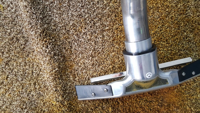

Mytee had their original swivel on the original Bentley which was not used on the new version. Failures were common as was "stiction" or a notchy feeling. Far too loose an action for my preference.
Mytee's new swivel is a bit stiffer but has lots of slop. I'm not quite sure if the model we had was broken internally. The new Bentley is by far the lightest of the Swivel wand options. The metal glide is a deal breaker for me. I would expect a teflon option from Green Glides down the road.

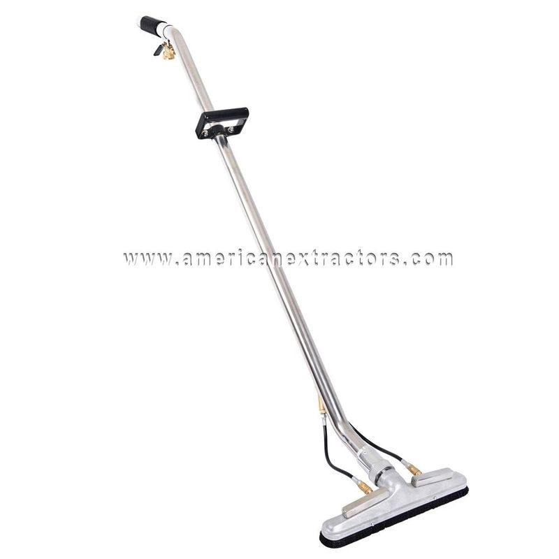

Devastator wands. There are many swivel designs being used on these. Lots of confusion. The best/most durable were those built by Tom Conway. Nice stiff action and almost no failure issues. Stiff is best IMO.
Tom's "Dev Pro" was a collaboration between Tom and Caltools and is no longer available.

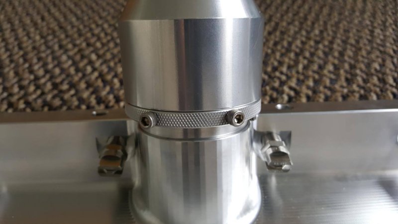

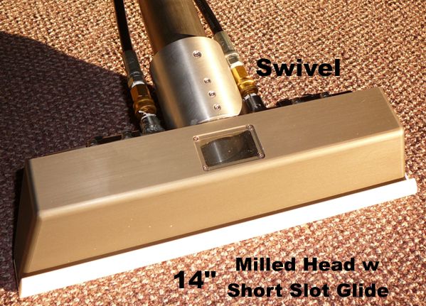

CalTools displayed a new and hopefully improved swivel in Atlanta this past week.
6 tiny screws hold the mechanism together and with the use of two Allen screws you can lock out the swivel action. I was very impressed with the manifold and jet placement on this new head.

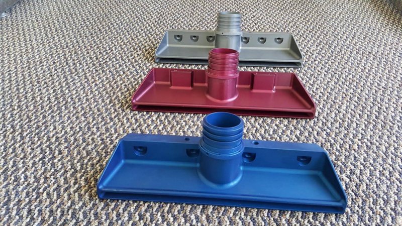

The manifold did add very noticeable weight to the wand compared to the red model seen above.
