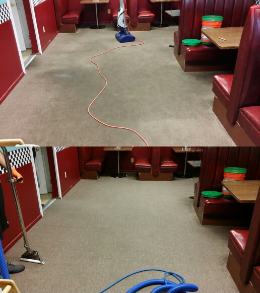

I have a few pictures from last weekend. This is a little fast food ice cream place. The carpet here sucks, super short and thin, gets dirty in like a week. Doesnt help that it is right on main street and the people coming in are mostly workers with muddy feet. IT cleans up pretty quick.

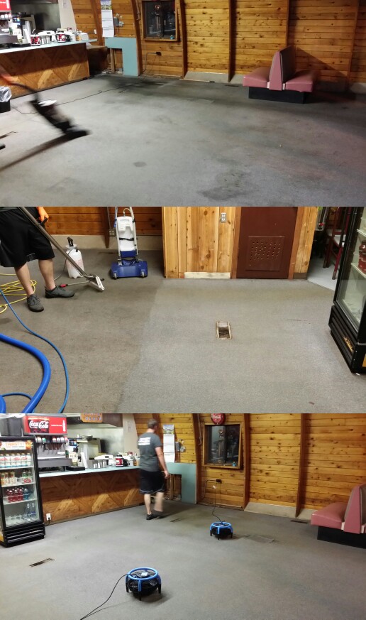

This is another restaurant here in town. Hasnt been cleaned in a lot of years. Going into the kitchen on both sides it was black, you can see it in the upper left corner of the first picture. The middle picture goes into the kitchen, you can see the edge of the tile. After cleaning the black stuff it just left a little brown and that was good enough, not sure how much more I can get out. I had her quoted at a price and she just wanted me to clean for that much so I wasn't going to spend all night there. She was happy and very impressed with how things turned out. For both this one and the one above I used Prochem Heavy Artillery and rinsed with Liquid Slurry. First time using these chems.

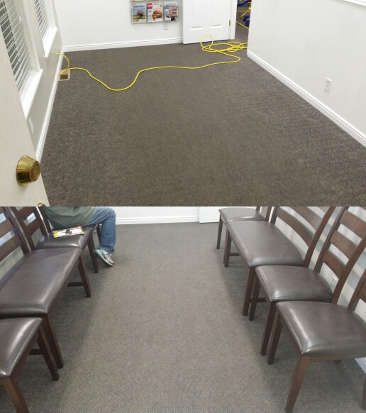

This last one is the dentist office. I am sure there is a difference in the color of the picture because I know it isnt that much cleaner but you can see a difference in the amount of dirt and grime from the top picture and the bottom. I used Extreme Clean on this. BTW, Not sure if anyone else is doing this but I mix it in a coffee pot that runs off an inverter in the trailer. Works wonderful!

Going into the kitchen on both sides it was black, you can see it in the upper left corner of the first picture. The middle picture goes into the kitchen, you can see the edge of the tile. After cleaning the black stuff it just left a little brown and that was good enough, not sure how much more I can get out..........
Sometimes a special batch of nuke juice is good to have on hand for such areas, or to mix up a special batch as needed.
A separate sprayer full of your favorite pre-spray mixed very strong, or a good stiff cocktail of warranty-voiding degreaser can help, especially one containing Sodium Hydroxide (generally the caustic purple stuffs).
Having an Oreck, or any other rotary/orbital machine for that matter, would offer more options as far as varied pad aggressiveness and soil removal capabilities, where the Procaps machine does not.
Working in some secret sauce with a red/green scrub pad may make a difference.
An absorbent Microfiber/cotton pad with some stiff encap juice may very well remove additional soil, and may make future cleanings a little easier.
The ability to post-pad-cap any areas not to your satisfaction with an absorbent pad, to remove additional soil is a great option to have and can really help fine tune the final appearance on commercial areas.
I would recommend a kitchen entry walk off mat to mgmt, and warn them of future deterioration without one, not only to make your job easier in the future but to further distance you from responsibility/judgement if they don't follow your advice.
