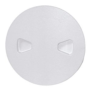

Also you can buy the ports like you see on porty waste tanks, with the 6" screw-in cover from several places.
Here's an example :
http://www.westmarine.com/buy/west-marine--screw-in-deck-plate-8-smooth-white--11743069
