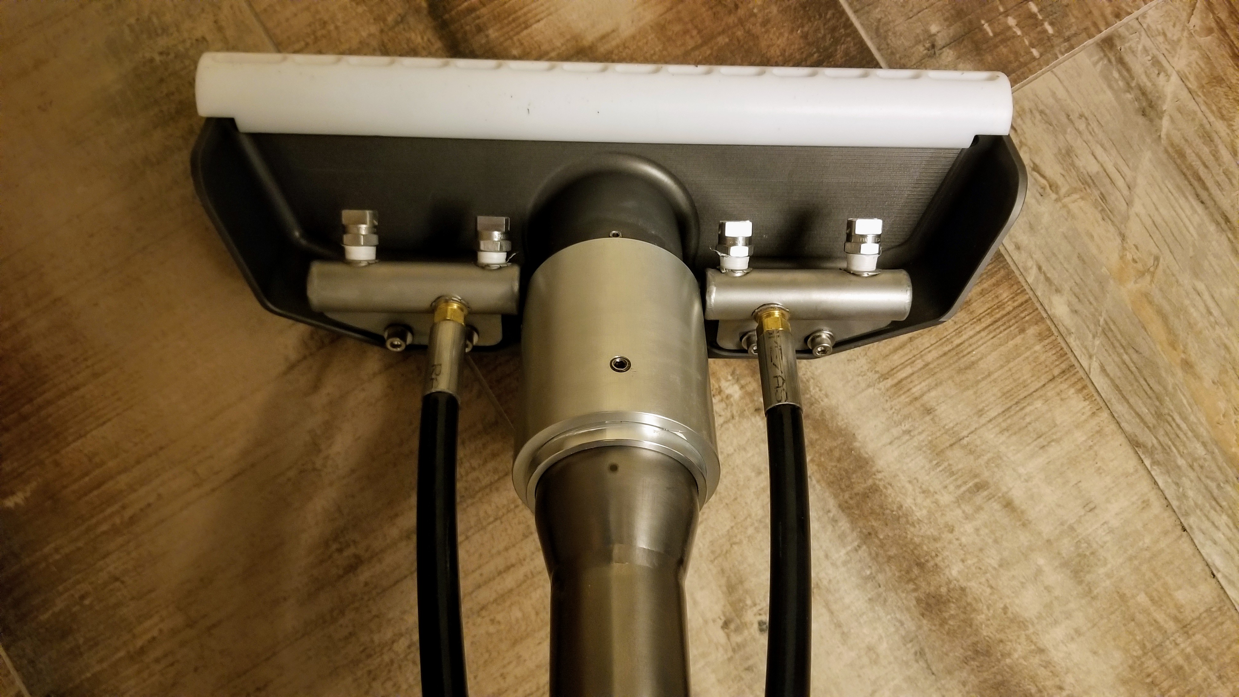

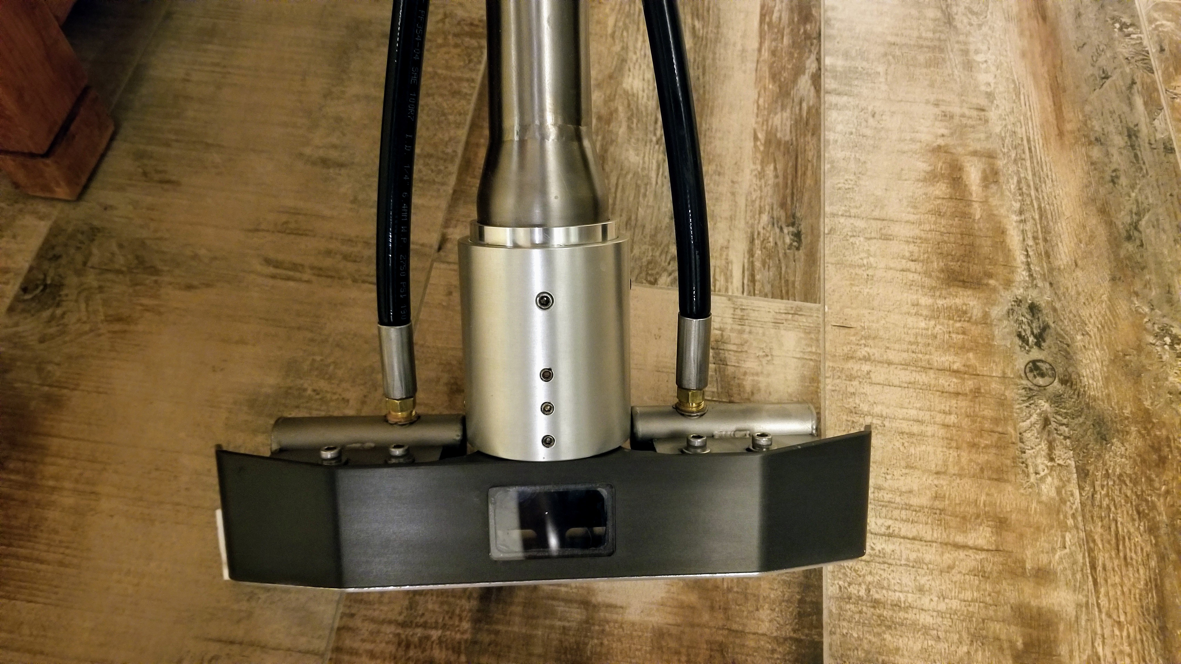

Why haven't any wand manufacturers tried this yet?

Probably because nobody would by it.
What's so special about it besides the large amount of labor that goes into making it? It looks odd to me.

It might be alright. They moved the expansion chamber closer to the floor where it's needed most. I guess

If the 2" flare makes a real world difference ie a vacuum reserve buffer, then a full 2" tube to those small girly hands 1.5 hand area would surely work better.
more tube = more buffer = more effect..
unless you've got less, then you compensate mentally and verbally

Makes sense to me. The 1.5" tubing provides more lift but less CFM than 2" throughout. So having 2" closer to the floor would allow more water recovery initially and then the 1.5" would provide quicker evacuation because the lift would take over likely creating a cyclone or funnel type of effect. Will work well so long as it flares back out to 2" at the vac hose attachment to keep up with volume which I'm sure it does.
