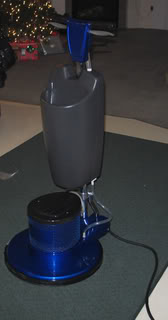

This Clarke was $200 On Craigslist I did the custom powder coat job on it.
