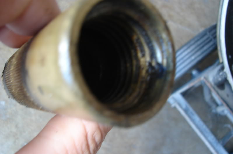

I tried taking off the head to my CMX20 aka RX20. It wouldn't budge. I wanted to change the seal since it hasn't been used in like 10+years. My pops loaned it to a fellow cleaner and he broke one of the head bracket. He did replace it, but it has always ran uneven after that. It would consistently torque making it very uncomforable to use. I did use it on a 12 floor hallway job and man did that suck!
Anyhow, I sheared off the 2 tiny bolts that held on the vac shoe to the one that got replaced. I was using a mallot and a 2x4 striking the bracket. Then, I took off the bolts holding the star onto the vacuum port (composite plastic). Then I proceeded to try and use 2 bolts and a long piece of pipe (for leverage) to crack it loose. It broke one of the seats that hold the star onto the composite plastic piece. All hell broke loose after that. :evil:
I still haven't gotten the piece off. Before anyone asks, I did use a box wrench to hold top from spinning. I did hit it counter clockwise. I read hear that someone else had problems with removing the star too, but I couldn't find it in the search field.

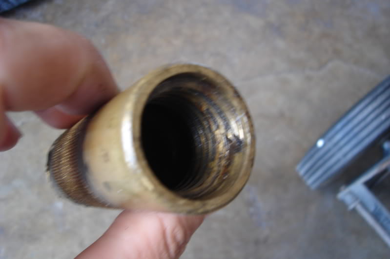

Is it the single thread or double thread hub?
That's a good question. However, I don't have the answer for you yet. I just seen the same thing when I looked up the parts on interlinksupply.
I need to get the part off before I will know. Thanks for bringing that to me attendtion. :D

You know it's reverse thread, right? Turn the star clockwise to remove.

You know it's reverse thread, right? Rightie loosie
So counter-clockwise while looking at the bottom of the machine is the wrong way?
Counter-clockwise to tighten. Clockwise to loosen/remove. (Reverse-thread.)

I was able to get the part off. Yes, clockwise was the answer.
It looks to have double threads.

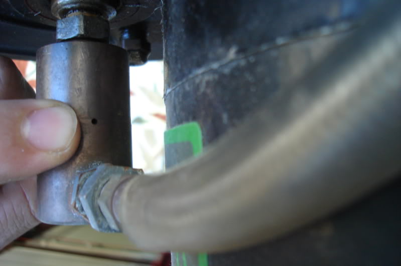

Also, what would cause water to drip out of the tiny hole on the top where the solution line meets the brass piece?
Bjorn
2,450
that is a rotary union and your going to need a new one the seals are shot

The slow speed is a single thread hub and nate's is a double. We have all the parts on stock. You need a hub,star and rotary union. I'll email prices monday
