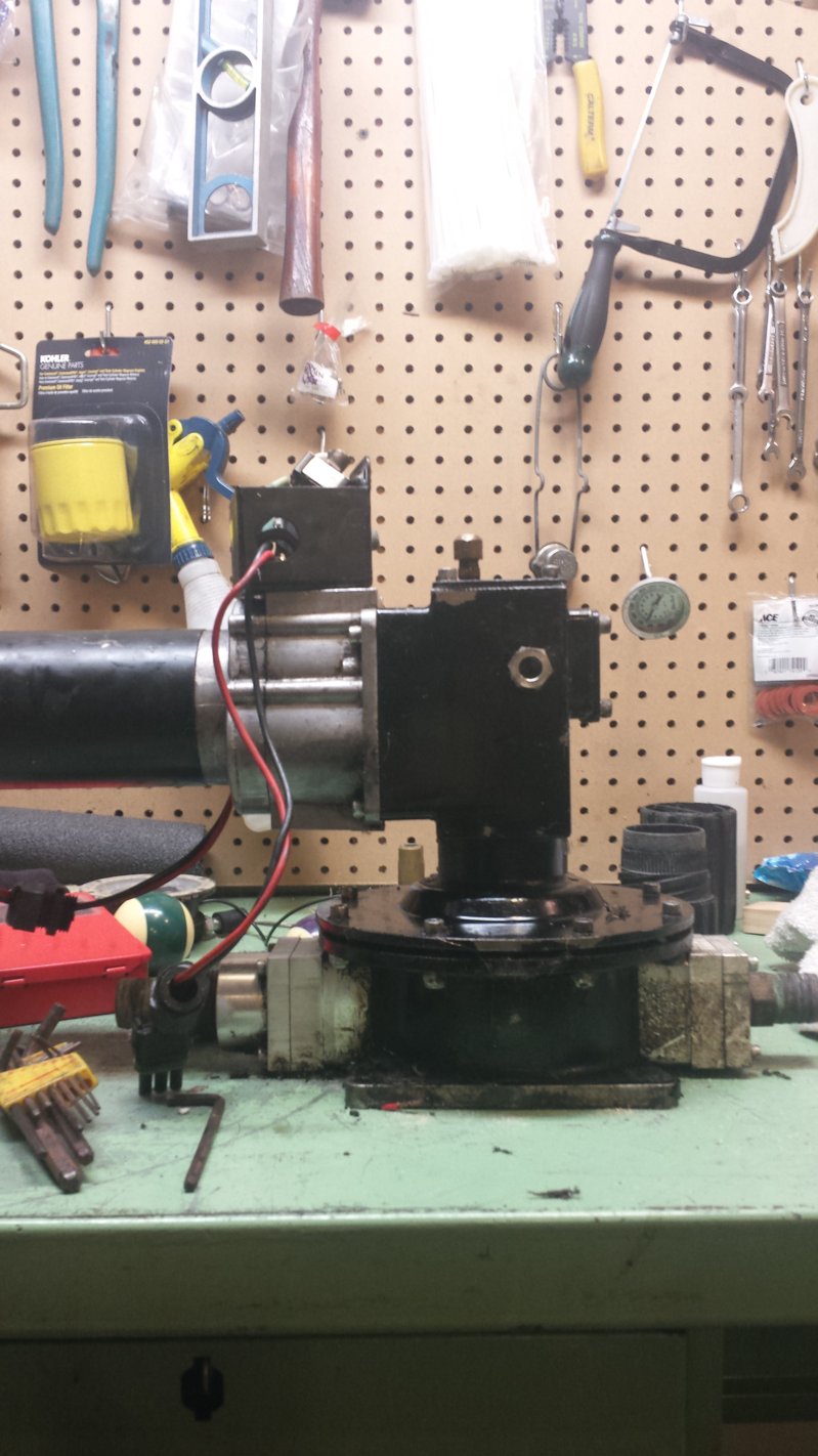

I want to rebuild this thing,and there isn't any sticker as far as who makes it..

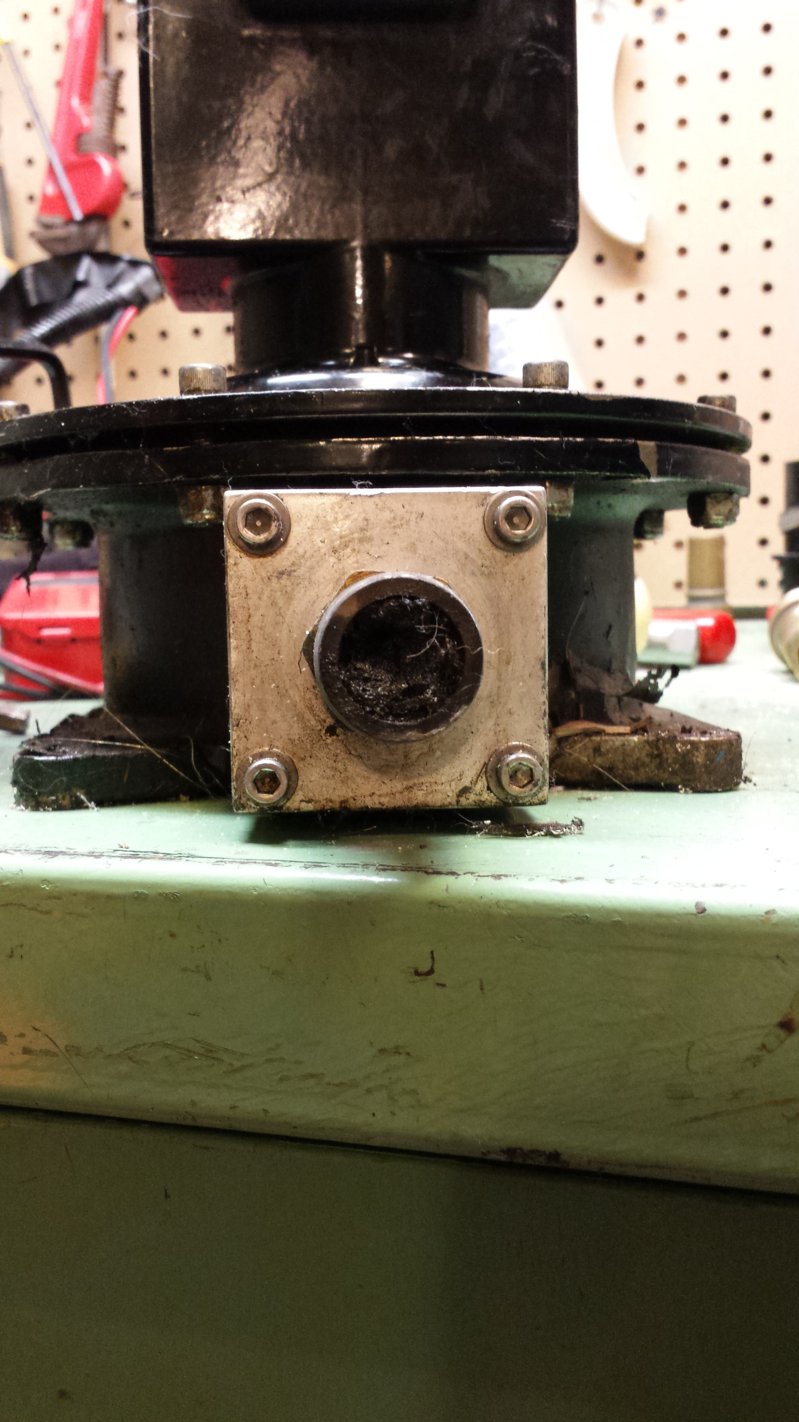

If the motor is still working, I would suggest just giving it a good cleaning. The rubber diaphragm could be ripped, or it could just be the check valves it should have one on each side, they work together to keep the water pumping out, from the amount of debris in the pic, they could just be stuck open.
These are very simple pumps and work really well, pump just about anything as long as it can make it through the two ports.
I was trying to make one out of a windshield wiper motor...it pumped a ton of water, but just like the one above it hadf a pretty good surge as it works so you might need to place something on the hose to keep it where you place it.
Awesome pump out you will be happy once you get it going.

Jim Martin was repairing them for people a few years back. I'm sure he could give you tips on it Keith. I have one that came with our PC 805. They work great if you use them regularly but like all pump outs if you don't use them they can have issues when you finally go to use them.
I'd keep a couple of diaphragms on hand just in case one goes down on you.

I have a couple of these
The stock balls became oblong and didn't seal. Remember getting an upgrade white ball.
As will all pumps that use springs. Hair is the killer. Is good pre filtet no problem
It will to pas 3/8 gravel.
If you do use. Look into an expansion blatter( used by plumbers) on the exit. With every pump the end of the hose will move

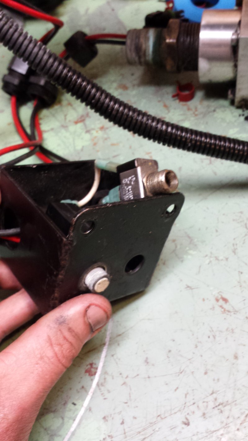

So, breaker and on off toggle switch? What is the breaker set at?

That pumpout was used on the Avenger 600 (among others) and the wiring diagram shows the breaker as a 20A.
