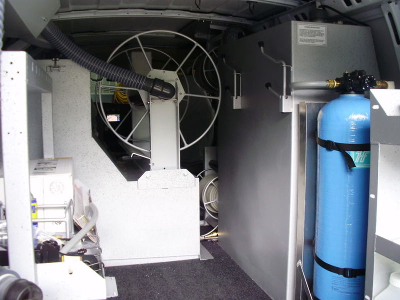

I have mine installed in the right rear corner........the one that you have in the picture is just a little bit bigger then the free standing type with out the brine tank..........
11,197
Grand Rapids, MN

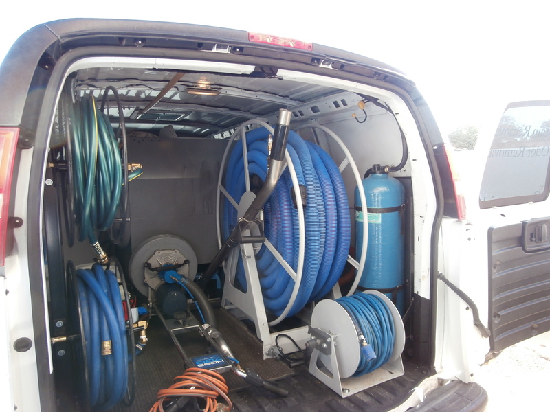

Here is mine in an extended GMC and Butler unit. Have also ran one behind the hose reel, but found this a better spot for us between fresh tank and back shelf.
11,197
Grand Rapids, MN

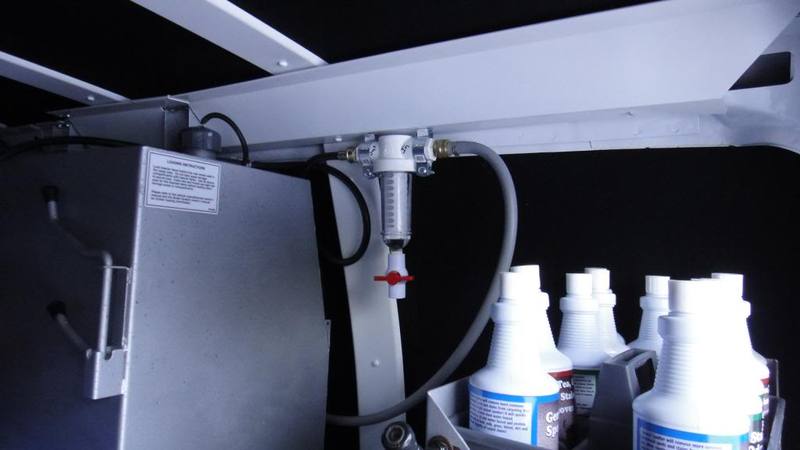

Also have a filter before the softner
and found another pic when ran behind the hose reel...but changed it to like first pic.
