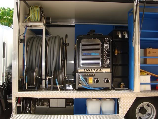

It is set up to run dual wand. The solution hoses are set up live, as is the electric wind up water supply reel above the stainless vacuum hose reels. The A.P.O. hose also sits on a reel underneath the body.

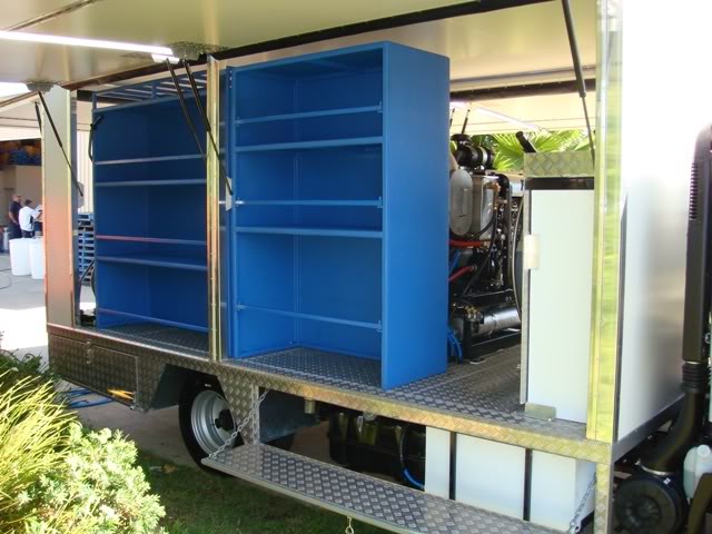

The racks on this side will hold 9 air movers safely on the blue line-x racking.

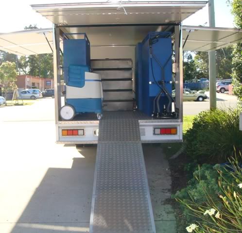

This ramp slides up underneath the pantec. It is used for wheeling the portables out, or dehums and makes for easy access into the back of the pantec.

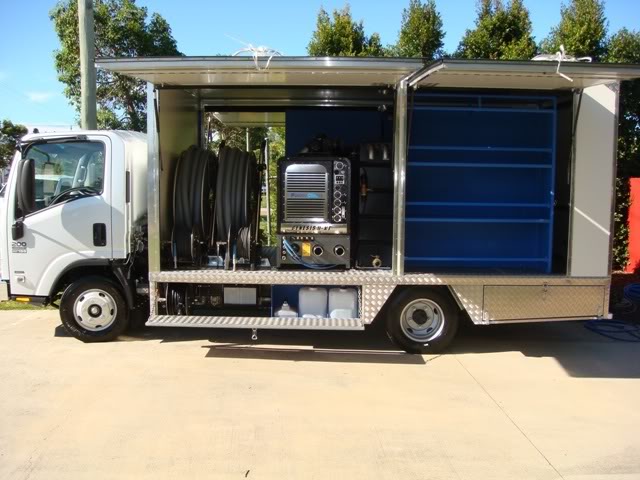

This is the other side of the truck showing more airmover racks. This truck now loaded can easily carry 27 airmovers on racks, and has several dehum tie down points as well. In this photo, you will also see a white fresh water feed tank above in the directly behind the cab (inside the pantec) and another one underneath. These can be used as either fresh water feed tanks, or waste water tanks.
