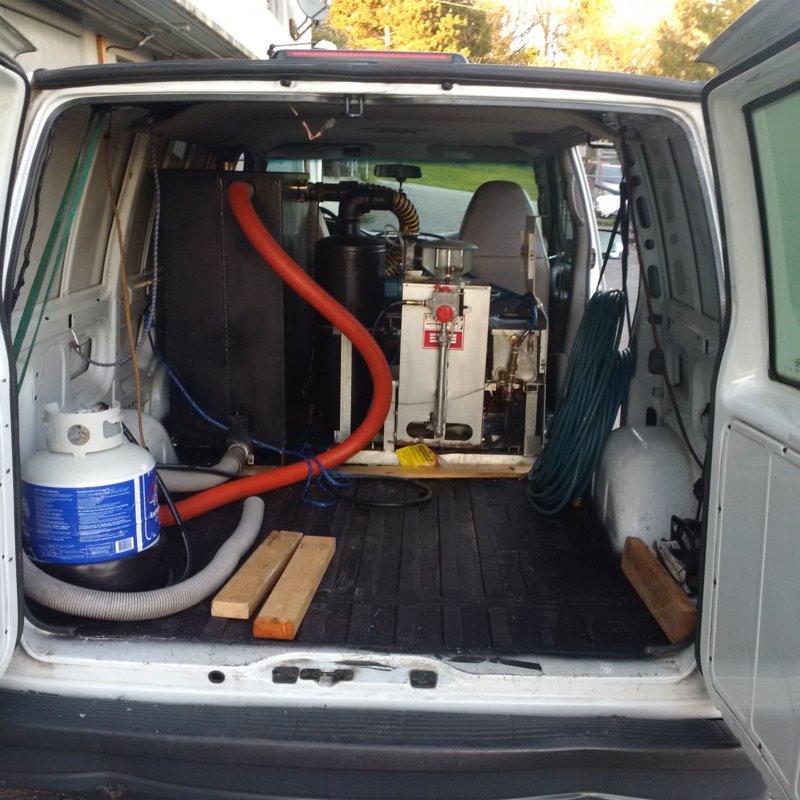

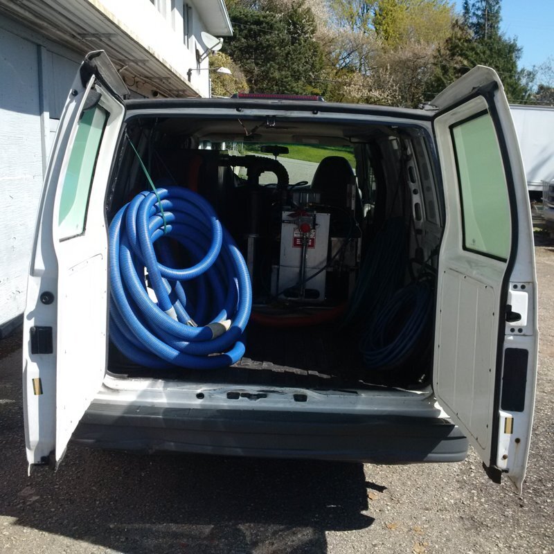

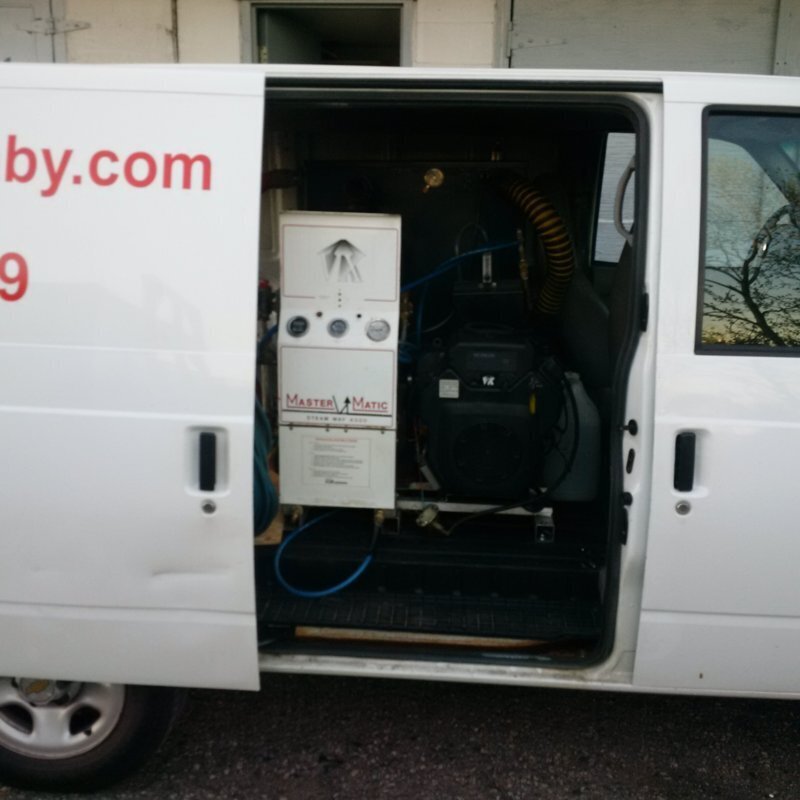

Just finished putting together my back up van. 2005 Chevy Astro with a refurbished Steamway mastermatic. N0 more kerosene, just a little lg propane heater. Gets me up to 200 degrees. Still have room for my portable and a few extras. Let's me get into smaller underground parkades for portable work and still performs well with up to 200 ft of hose. Thanks to Marek, my master fabricator neighbor who made all the brackets and fabricated the bolts.

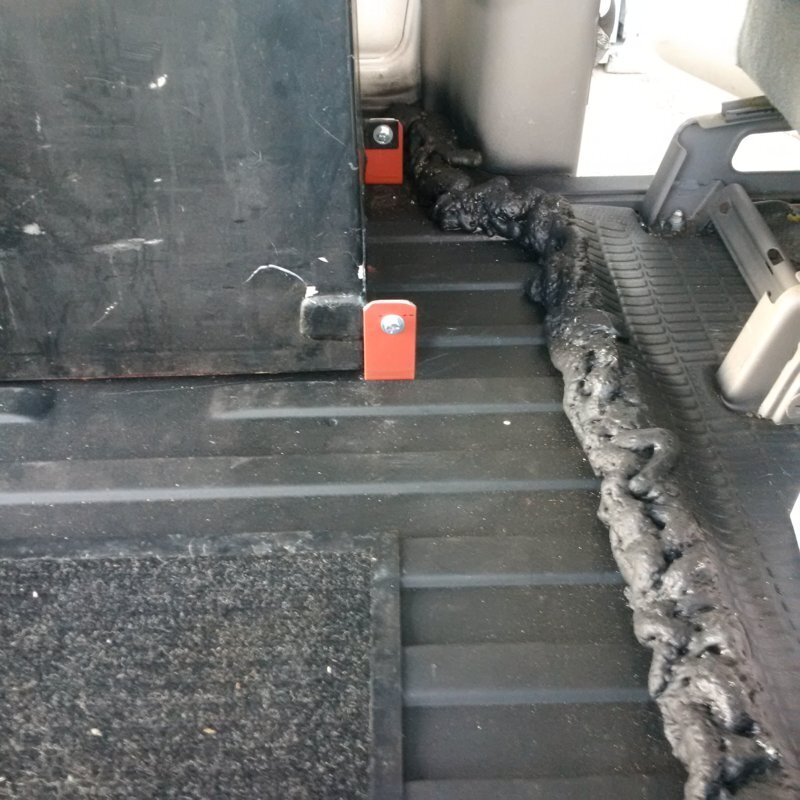

Yeah, I used it to make a dam, so that if I have a leak in the rear of the truck, it won't run forward.

Yeah, I get about 450 kilometers to a full tank, about $70.00. It's the second one i've owned but the first i've ever put a tm in. 2003-2005 they put larger wheels and brakes. It's a little smaller than my Volkswagen but it carries a decent load. The cleaning works great for a small unit. I'm pulling 15 inches at 3000 rpm. Probably 200-250 cfm. Feels stronger than that but that's what the specs say.

Just working out the bugs today, Vacuum is incredible for 3ll blower. Used it to clean a rug in the shop, was just about dry after 2 hours. I have a guy coming down to look at it tomorrow. If it sells, I can start my next project.
