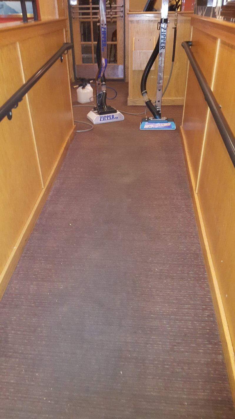

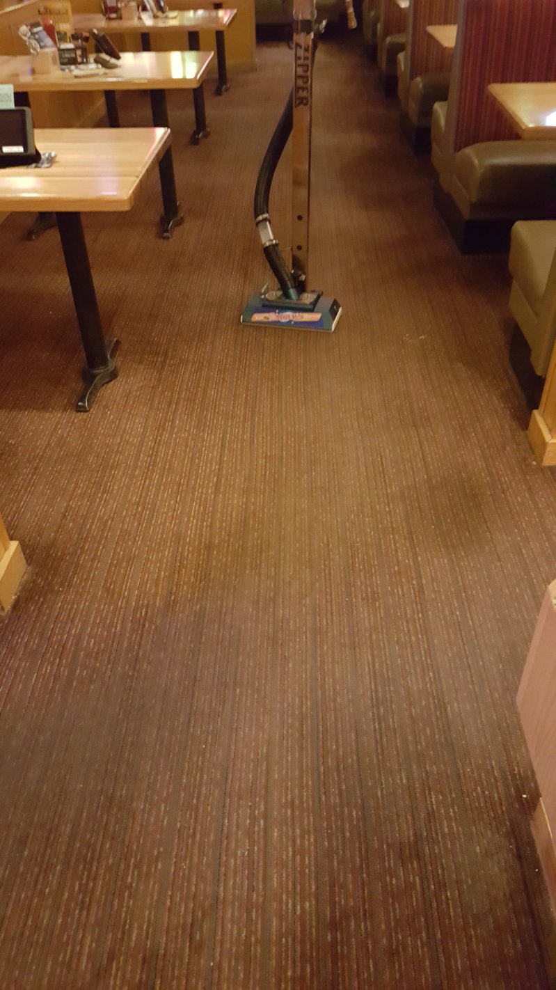

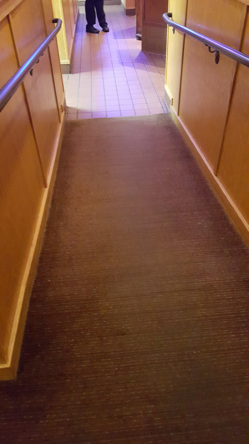

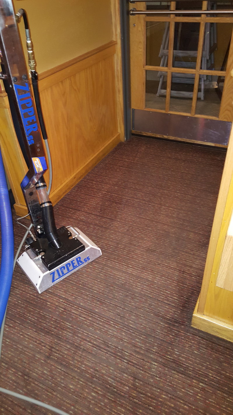

This place does not have their carpets done often enough really, but one of the managers told me they tried another cleaner from another town...I could kind of tell because there was some delamination coming out of the kitchen....
Cleaner was a friend of one of the managers that was there for a little bit apparently....
Guy came in with beat up equipment....took over 5 hours to clean (1.5 hours for us with 2 vans and Zippers)
I was told, he wasn't worth any money they paid him...as they didn't see any difference....
And areas like this is really where that Zipper SS Super Spinner Shine!
