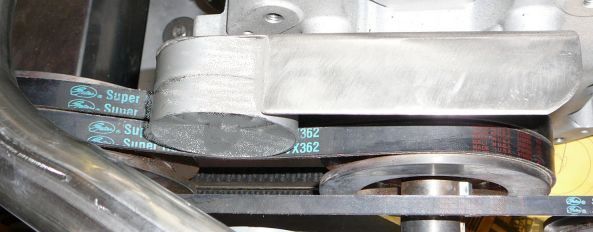

How many of you have V-belt idler systems?
I know that Vortex has a belt idler for their PTO system.
Bruce just finished this new stainless model for our 34 & 38HP Kohler drive systems. It makes belt tensioning an easy process.

John for Johns Heat Exchangers is making one for me that bolts onto the blower. His version will pull up on the belts rather than push down; easier on the belts that way. His is also fixed tension rather than automatic.
He was referring me to use 2- 5V belts on my system.

The bottom of the 5VX belts are segmented. I would not want a tensioner on the segments.
The Gilmer Timing Belts can handle a lot of horsepower, but they would have a problem with stuck blowers.

John has figured all this out. The 5VX, or 5X belts will work. The Gilmour belt won't because of the segments. The tensioner that John is building pulls up on the belts rather than push down. I just realized I'm only usign 2 A belts. I'm only running it at about 50% and carpets are drying within an hour or two. Can't wait to get a couple of 5belts on it and crank her up!!

Every Hammer, SledgeHammer and PowerPak I built featured a tensioner. I learned early- on that pushing in from the back of the belt reduces belt life, so I got away from that.
The reason it reduces belt life is that it causes the belt to flex backwards, after having flexed "forwards" as it goes around the pulleys. As a result, the belt is constantly flexing back and forth, at about 3,000 times a minute, which has an effect that's similar to bending a piece of metal back and forth... it creases and weakens it. This becomes accelerated as the belt is larger, because the tensioner pushes further downward, making the backwards flex even more.
Having a tensioner inside the belt, pulling out, then, is a more natural way for the belt to flex. And using a V-idler on a V- shaped belt poses no problems on a belt's cogs, if it has cogs.
It's true that a serpentine belt, like some used on automobiles and some on riding lawnmowers, however, can flex backwards without noticeably- increased wear / reduced lifespan. But they're specifically designed for that.
