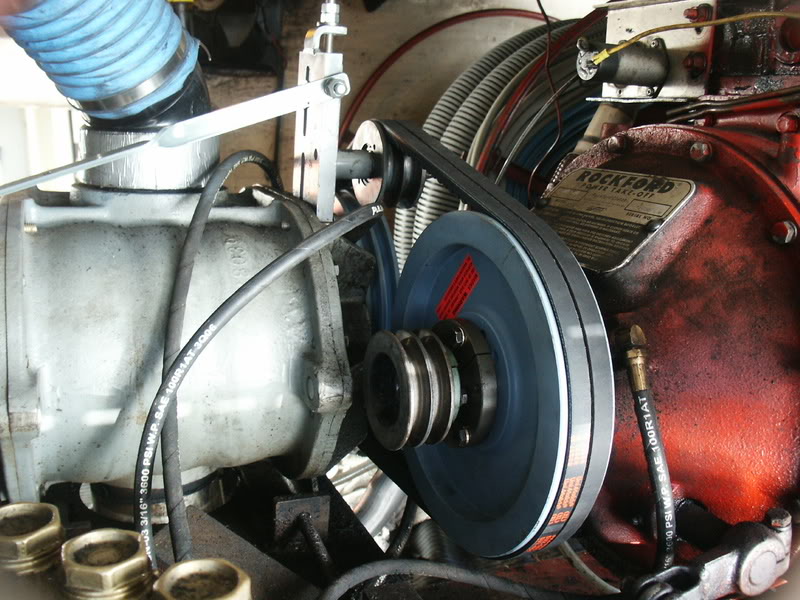

I'm considering the possiblility of adding a tensioner pulley to my blower belt system. This would be an attempt to make belt changing easier. Currently it is a very difficult and time consuming job. If it were only once a year it wouldn't be so bad. My question is where can I purchase these kind of parts. It needs to be wide enough to handle three 3VX belts. Its seems to me that I've seen something on some other TMs.

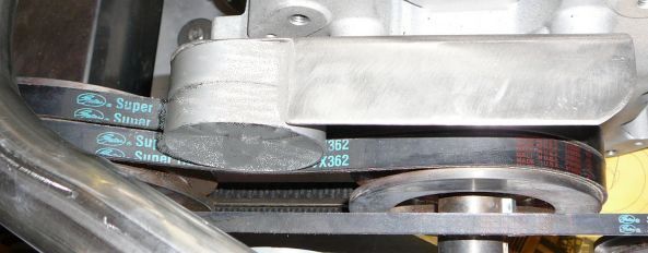

Took a little extra engineering to make it fit but it works great.
Got it from John's Machine Shop.

Thanks Ron, I need mine to ride on the back(flat) side of the belts. I will give John a call, maybe he can get a different pulley to fit. Besides making it easier to change belts I want create more surface for the belts grip the drive and blower sheaves.

On the belt tensioner ...
We do have a stainless ball-bearing design that mounts on the engine.
It was designed for the flat side of several 3VX belts.

Larry, That looks like what I'm looking for. Is your tensioner self adjusting(spring loaded)? Will it fit on my 31 horse Agies? How much is it?
