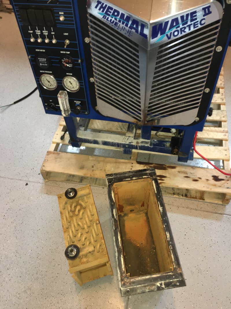

Lets talk about cutting corners. Here is a blue line thermalwave 2. Instead of building an aluminum Box to hold the coolant HX, they used steel. In mass production this aluminum box would have been cheap to make. Take a look at it. The HX is coverved in rust from the box deteriorating. All this rust has been pumping through the water pump day in and day out. IMO, they do this for 2 reasons, to make an extra buck of profit and because they dgas how your machine is holding up 5-6 years down the road. They want you to purchase another one. And of course the waste tank is aluminum.
I think there is a couple of factors at play at least. First is weight savings, second generally aluminum is cheape, third is it is easier to fabricate as aluminum is easier to weld. Fourth is it won't rust not even surface rust but will get eaten by electrolysis.
I don't like the use of aluminum for truck mounts but most of the time you will be just fine with enough care. Problem lies there in that most users don't care.

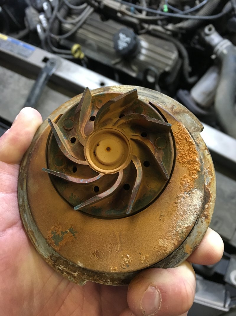

I put 18k hrs on that coolant hx with no problems. Engines have been made from cast iron for ever. The thing about antifreeze is the properties that stop it from freezing never go away. The anti rust properties however degrade with time. Most guys don't change it the way they should. By the way the rusty water is only going through the engine.

Lets talk about cutting corners. Here is a blue line thermalwave 2. Instead of building an aluminum Box to hold the coolant HX, they used steel. In mass production this aluminum box would have been cheap to make. Take a look at it. The HX is coverved in rust from the box deteriorating. All this rust has been pumping through the water pump day in and day out. IMO, they do this for 2 reasons, to make an extra buck of profit and because they dgas how your machine is holding up 5-6 years down the road. They want you to purchase another one. And of course the waste tank is aluminum.View attachment 9088
ok, i have some input on this. (manufacturing experience of 13+ years dealing with alum, stainless, exotics, etc.)
stainless steel is not impervious to rust. but at normal temperatures and conditions (atmospheric, not high heat) it will not rust. but at high temperatures with products that are poorly formulated and do not provide enough corrosion inhibiting agents stainless steel will rust, degrade, and or become brittle. aluminum will degrade faster then stainless and has far far less strength at high temperatures.
aluminum waste tanks are ment to be rinsed out often, same with stainless, you need an anode of zinc attached to the inside of your waste tank to sacrifice the corrosion onto instead of your tank if your using high ph products often.
as far as heat exchangers go, its better its made of steel then aluminum. descaling will remove a fair bit of rust if done often and properly. if your in a hard water area your should decale often, like every 3-6 months depending upon hardness, if your in a softer water area at least once a year.
descaling will remove some rust, but not years of neglect. if done often and properly it will keep you heat exchanges working at peak temps and reduce the amount of scale you find.. heating the water to high temps actually promotes scale, so decale often and neutralize once your done.

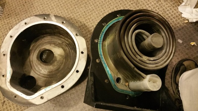

I had to replace mine when it sprung a leak, what an unbelievable PIA to get it out in the first place.
28,097
Did it spring a leak because it was poorly made or because it wore through. Every tm I have ever owned has had aluminum waste tanks. Never had a problem. Aluminum frames and tanks are lighter and very strong and more resistant to stress cracks due to vibration. There are different grades of aluminum, maybe some manufacturers are using cheap stuff
The copper chaffed inside against the coil plate that kept them in line
