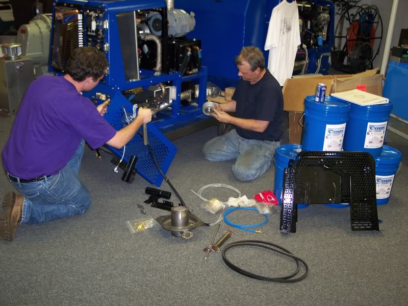

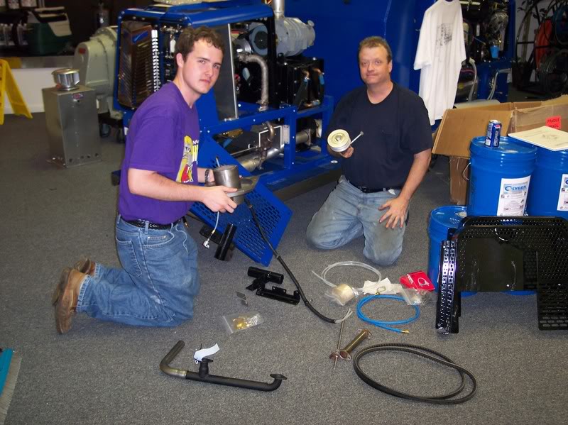

Where is that pic of Les with a brand new TW and all the parts in his show room floor?

Even in 10 peices scattered accross the floor the TW is still sexier than a C-4.
I know what pic ur talking about. Like that was the first time in the history of tm's a vac releif valve came loose.
Big deal...

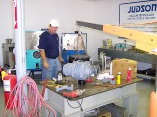

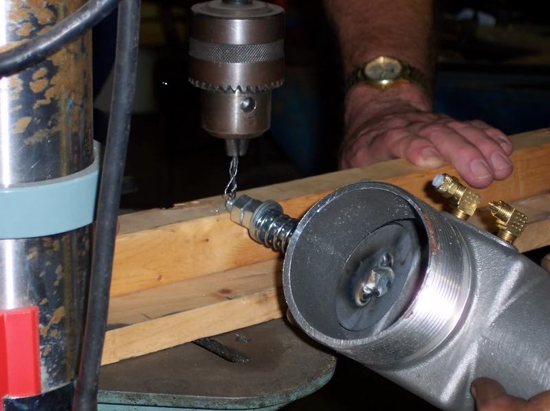

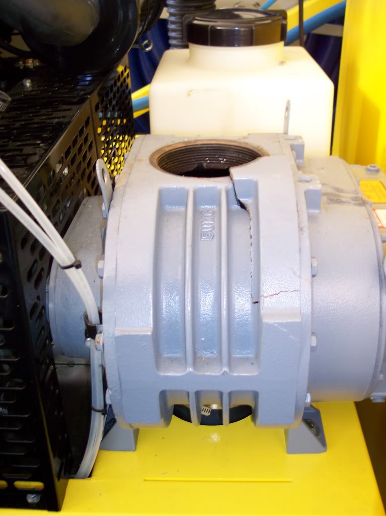

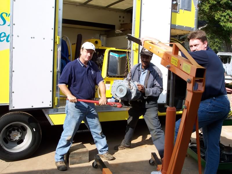

Greenie,

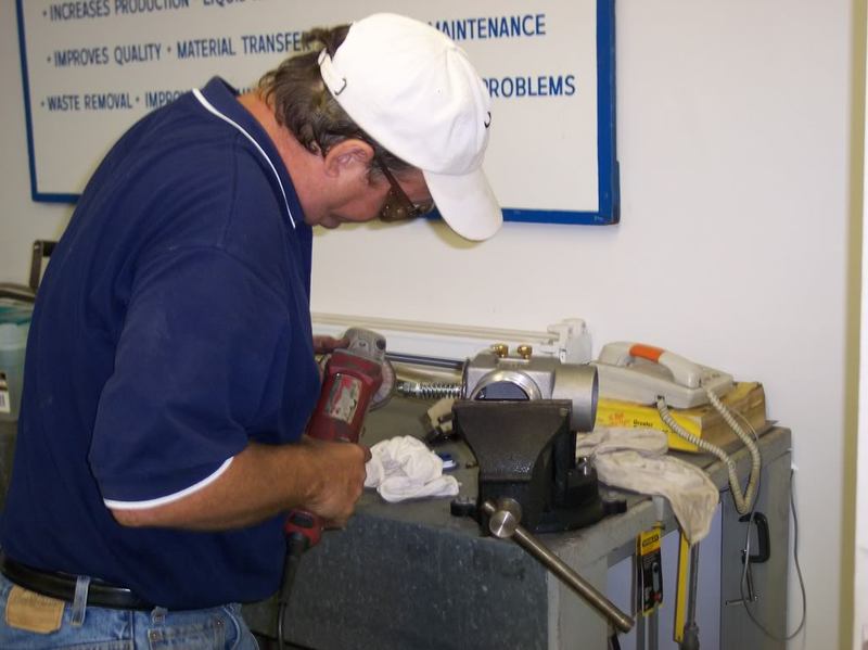

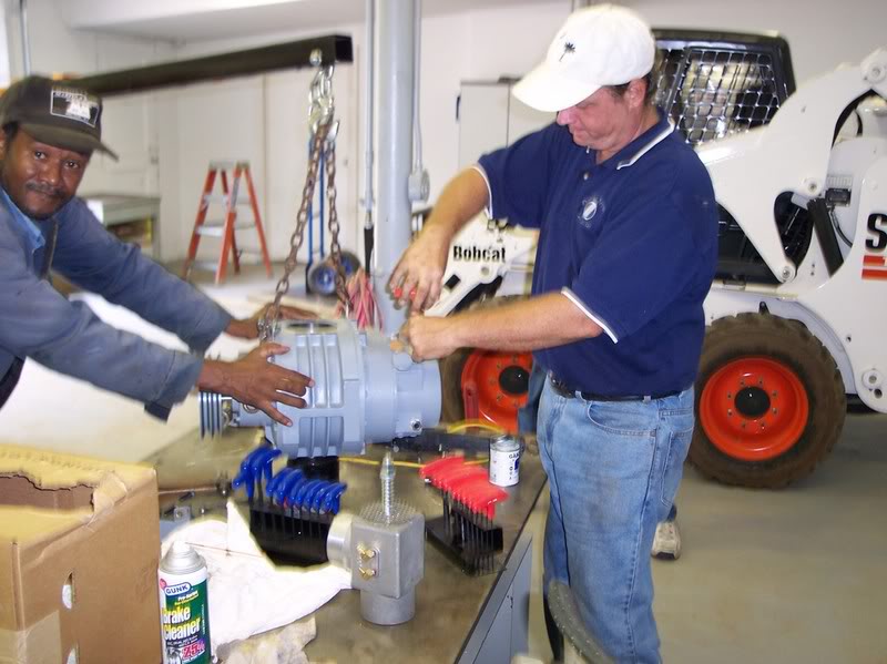

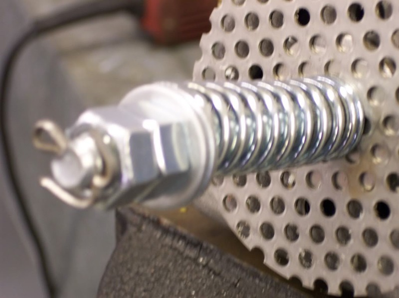

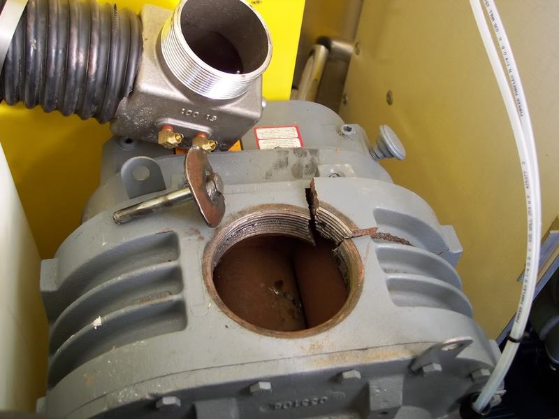

Here are the pictures you wanted. I’m going to go ahead and post them, seeing I never got paid for this repair. This is a Servicemaster unit that came in from Tennessee. The nut on the end of the vacuum relief valve vibrated off and the inside of the relief valve sucked into the blower. This caused the hand grenade. I replaced it with a brand new blower and I modified the relief valve by drilling the new relief valve and adding a cotter pin to prevent the nut from ever coming off again.

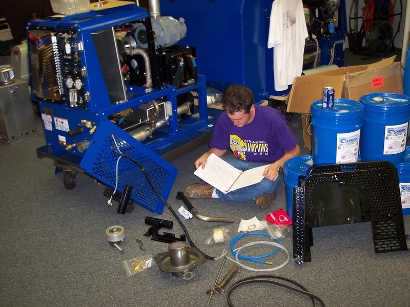

Greenie
6,820
How about the one in the SHOWROOM, the one where you had to do factory upgrades BEFORE it could be sold?
