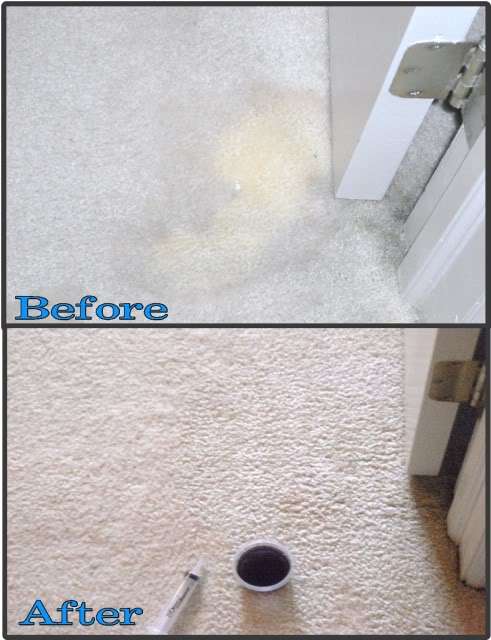

Made this little bleach spot look pretty good. I skipped a step by mixing purple instead of striking blue first then red.
Worked great on this beige carpet.
Yellow was there so add blue and red !
Looks great in my Before and After album as well.

Good sized mark and good colour matching

I used a powdered anti-chlor.
I only have and use the primary colors.
Blue-Red-Yellow

Wow, that is awesome. I can see how a customer would love you for that. I do have a question. How do you apply the dye? Do you just use a spray bottle? And what kind of dye kit do you have?

why is the carpet in before/after pics a different shade...not the spot dyed area, but everywhere else...not a great before/after pic (IMO) due to rest of carpet looking different. and the carpet with the discoloration is almost white...how due you add color and make a discoloration lighter?? You can make light turn dark...but not the other way around?? Hhmmmmmmm?? :?:

In this case, it's simply the use of flash. Both befores have got flash and both afters are without.

Just a suggestion: ALWAYS take several before and several after pics with and without flash. I hardly ever use the "with flash" pics. I usually snap around 20 per job.
Try to find a background ref point like an electric outlet or door jamb, always leave a pen, awl or biz card in the shot so that your camera has something to focus on and the viewer has an idea of the size. I also will leave a coin or card etc to mark the spots where my toes were positioned so that the "after" shot is from the exact same spot. Be aware of shadows, florescent or incandescent lighting in the room as they will affect how your pics will appear. On some color repair jobs, a high intensity halogen aimed at the ceiling works best until it falls over and burns a hole for you. :cry:

Peter, very pale blue dye can lighten a colour slightly.
It's not the same as, but a very similar concept to optical brighteners.
Some may remember 'Blueo' (I think that's how you spell it) sticks, that mums use to use a long time ago, in washing cloths.
It was a blue stick, and had the effect of brightening whites.

Nice work! Did you have to neutralize first? I can’t wait to take the color repair class. Is Jeff Cross a good instructor?

When using liquid dyes, you will need to neutralize the bleach.
