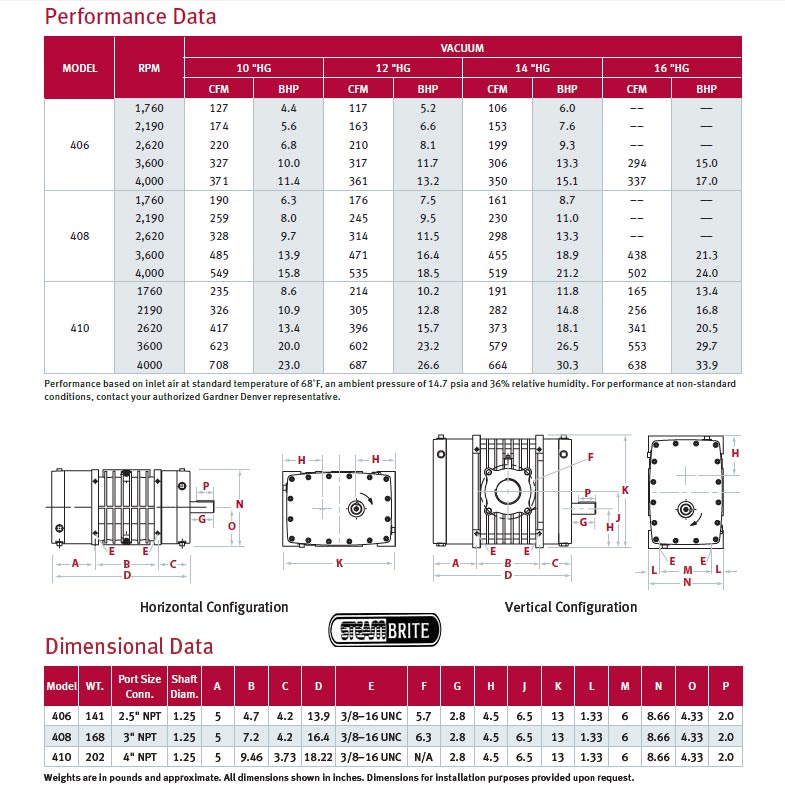

I’m hoping to learn the factory set RPMs of the blowers (and engines) on the Prochem 370, Peak 500 (same blower as the 370 but better air flow) and the 650.
Can any of the three be spun slightly faster through engine speed or pulley changes to increase airflow, preferably without causing long or short term damage to any of the components?
1900 North
Apr 23, 2013
105
Richard Swan
sapphire 370ss 3402 RPM (GD TI406)
peak 500 3402 RPM (GD TI406)
Everest 650 3125 (GD TI408)
Thanks Fred. Am I mistaken that the Peak set up moves more air than the 370? Just to double check, the 650 is a 408, not a 410? Can any of the blowers spin a bit faster without damaging the blower and improve performance?
you could provided the horsepower is still there at the desired RPM. The increased load/heat/etc would likely wear out components faster

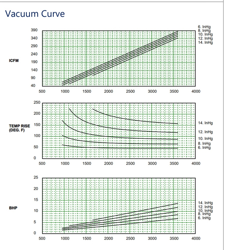

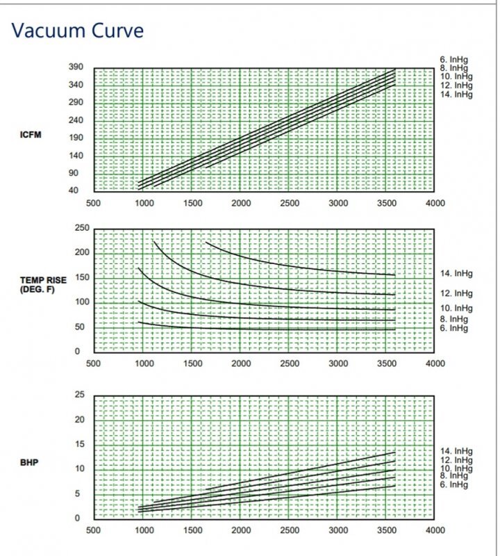

NO. The faster you run a blower the hotter its exhaust, largely due to the compression of exhaust gasses.
again only going off what I've read from old posts.
but thought the rationale was higher airflow less chance to pick up blower heat, therefore cooler?
higher Hg the blower is working harder (more heat) less airflow (more transfer of heat) theories are wonderful things

I think Lee is talking about the actual temp rise of the blower and you are talking about the velocity through the heat exchanges allowing less time to give up heat..
maybe I'm misreading the heat rise chart on urai 45?

If you restrict the exhaust of a PD blower the temperature rises proportionately. Thus many post blower designs severely do just that.
