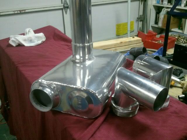

so how big of a difference does a ceramic coat make on a muffler? How does it compare to a blower silencer? That is a cool looking muffler and parts there.
prolly none louis....but it sure makes it purty......you are very correct about TWO EXPANSON CHAMBERS.....
a sine wave of noise has an upper sine as well as a lower sine......only i would put one up at the machine and another UNDER the truck.........
