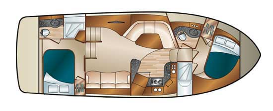

They told me is about 200 square foot, here is the floorplan:

That boat should have 50 amp service from the dock. Usually the outlets are split between port and starboard (left and right side of the boat.) Make sure you plug each cord in on the opposite side of the boat. There might be 200 square feet of actual carpet in the boat, but most of your work is gonna be with an upholstery or stair tool, as theirs gonna be a lot of small crevices like a motorhome. If that's the boat I'm thinking (Carver 35) your gonna need 50 ft of hose since the entrance of the boat is to the side, but the door to the cabin is towards the back. Your not going to be able to get a porty INSIDE the boat because the side decks aren't wide enough. Honestly if the docks not a mile away from where you need to park you might be better off using the TM running 200 ft of hose just because of the pita factor...

a boat that small will need a stair and upholstery tool. it will be slow but easier than a wand.

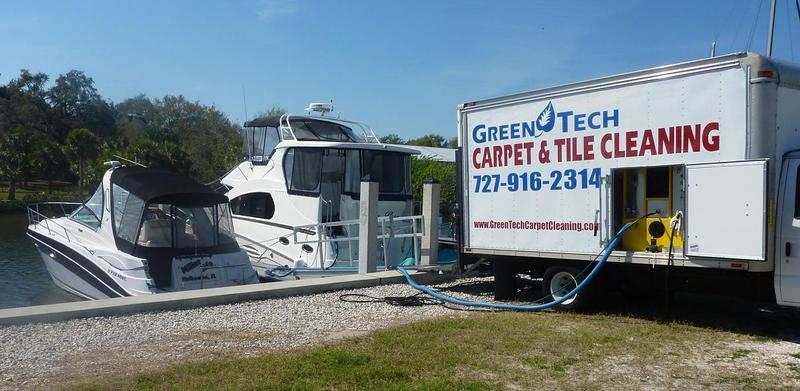

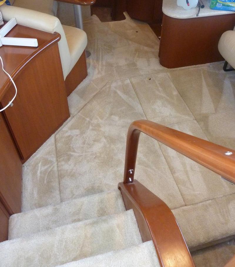

So I did the boat today and all wen't better then planned, TG.
What I did learn was no big deal, just like any other job except you are doing it with either a upholstery or stair tool on your hands and knees. I switched my 2 inch hose and run with a 1 1/2 leader because 2 was too stiff and bulky.
It was 81 degrees here today, which was nice, but the boat had A/C that made it a pleasure to work inside. Wish I had my camera, couple of dolphins were swimming around, that was very cool.
The marina was an island so all the boats dock in a circle around the parking lot which made pulling the truck right up to the boat no problem.
Got another small job while I was there and the marina manger asked for my cards to keep in the office.
Thanks to everyone for their help!

i hope you didnt leave all those footprints for the customer to see,i always leave a clean slate :oops:
G
greentech
I hand brushed them out as best I could.
Man, what have you got a jetpak!
It is very hard not to step anywhere in such a small space.
