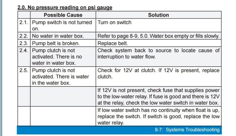

maybe some one wouldnt mind telling me,
its a newer boxer 421 and I was using it for flood extraction and noticed when I was done the pump clutch was turned on. now it doesent engage or disengage. any idea how much damage i could of caused? the machine also at the time had no water in the fresh water tank.
i'd expect any damage to be to the pump itself
i'd look for another cause of the clutch issue. Is it getting power? Fuse?
Reactions: Corey Houston
http://www.hydramaster.com/Portals/0/Manuals/man182-065.pdf
Reactions: Lee Stockwell

Check the wiring. Hopefully something just came loose. My boxxer had a wire that would come off.
If not, I would agree with Fred.

ya im actually laughing about it right now I just didnt have any water in my fresh water tank haha thank god though ive had to repair it when i first got it. the solenoid was bad and fuel filters.

At least your a man enough to admit it, I help a lot of guys that call me frustrated and I ask if there is water in the fresh tank and they let me know they will cal me back.
