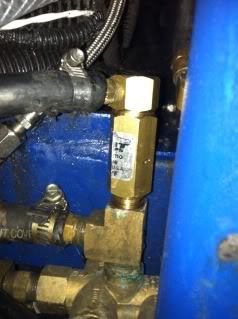

My Boxxer is dumping water into the waste tank. I thought the hot water dump valve was bad, so I replaced it. That wasn't the problem.
Any ideas?

my machine never did this.
I replaced the 180 degree thermal valve. Took care of the problem.
